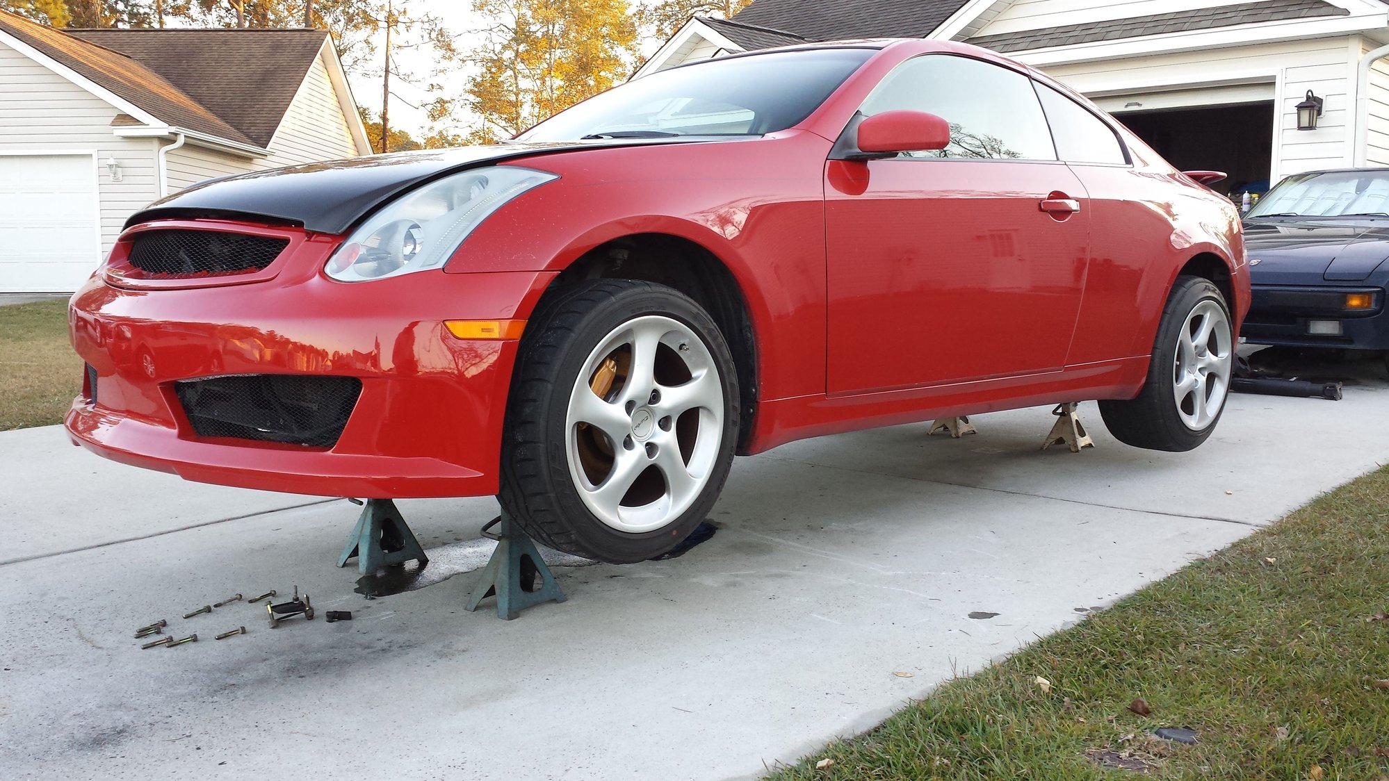

Well the plan was to do a lot of work on the car today, but this week was rough and I can't seem to drag my lazy a$$ out there. I got as far as putting the car up on the ramp/blocks I made so I can get the jack under the front, and popping the hood to cool the engine off. That's it.
Now I have to sit here and stare at these boxes for the next week or more...and no new mods

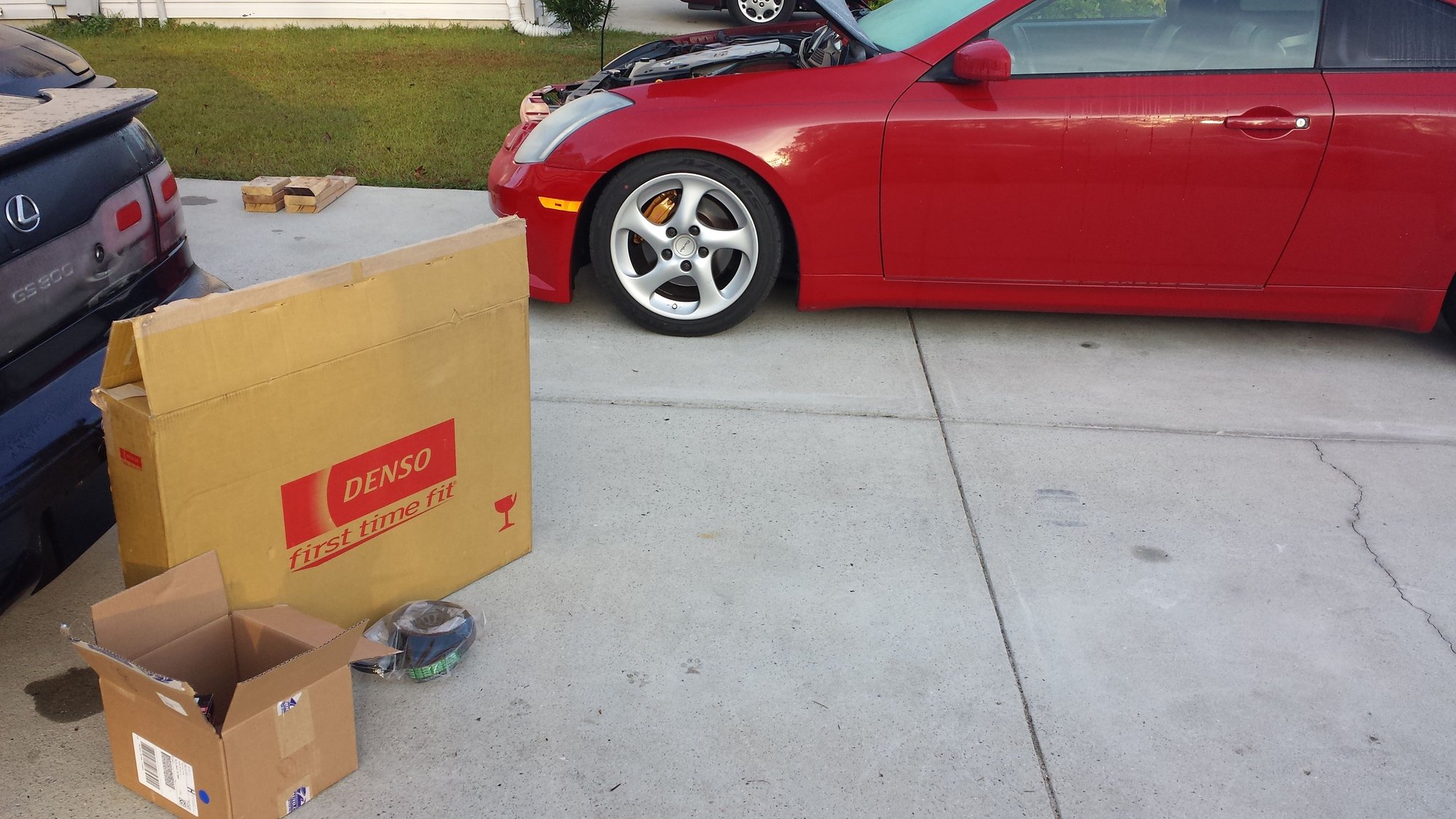

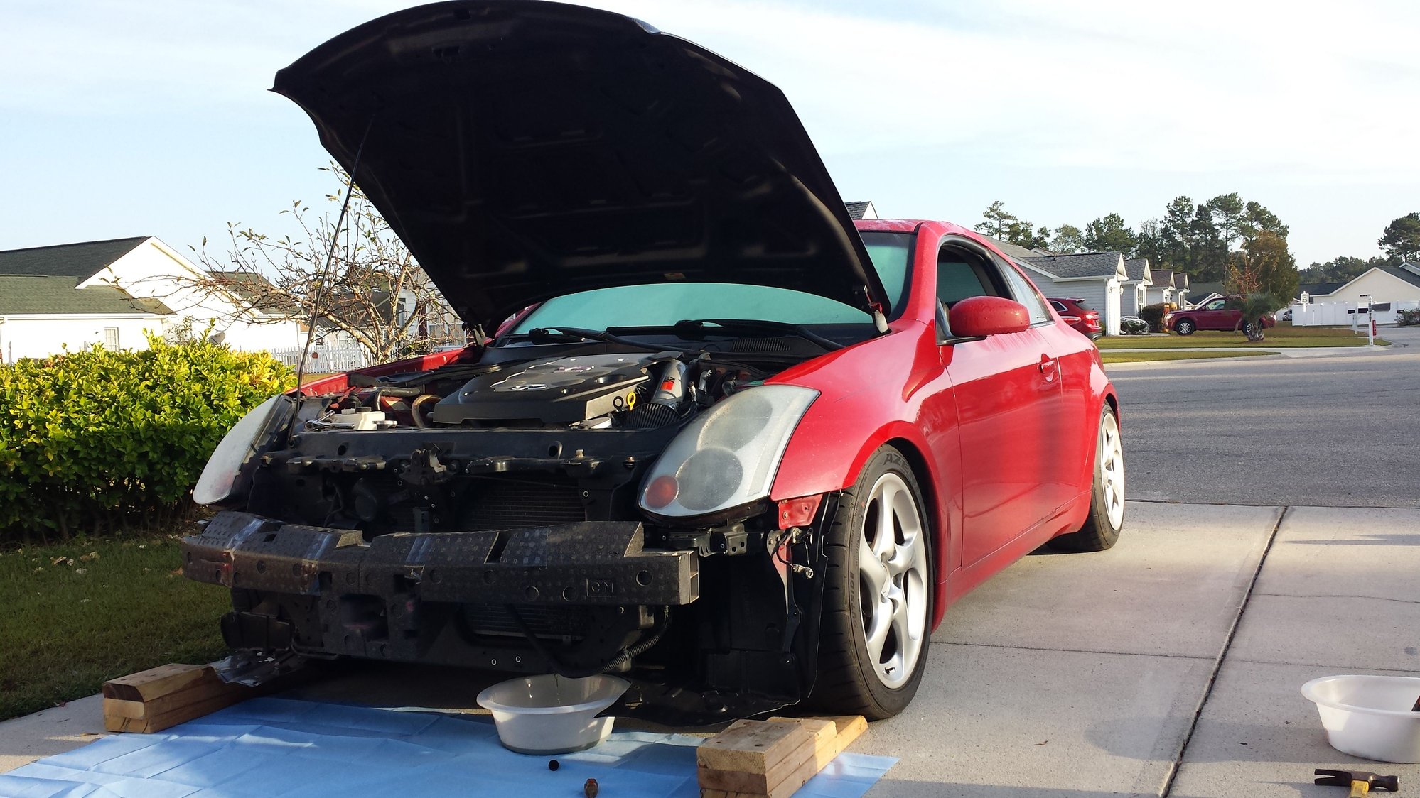

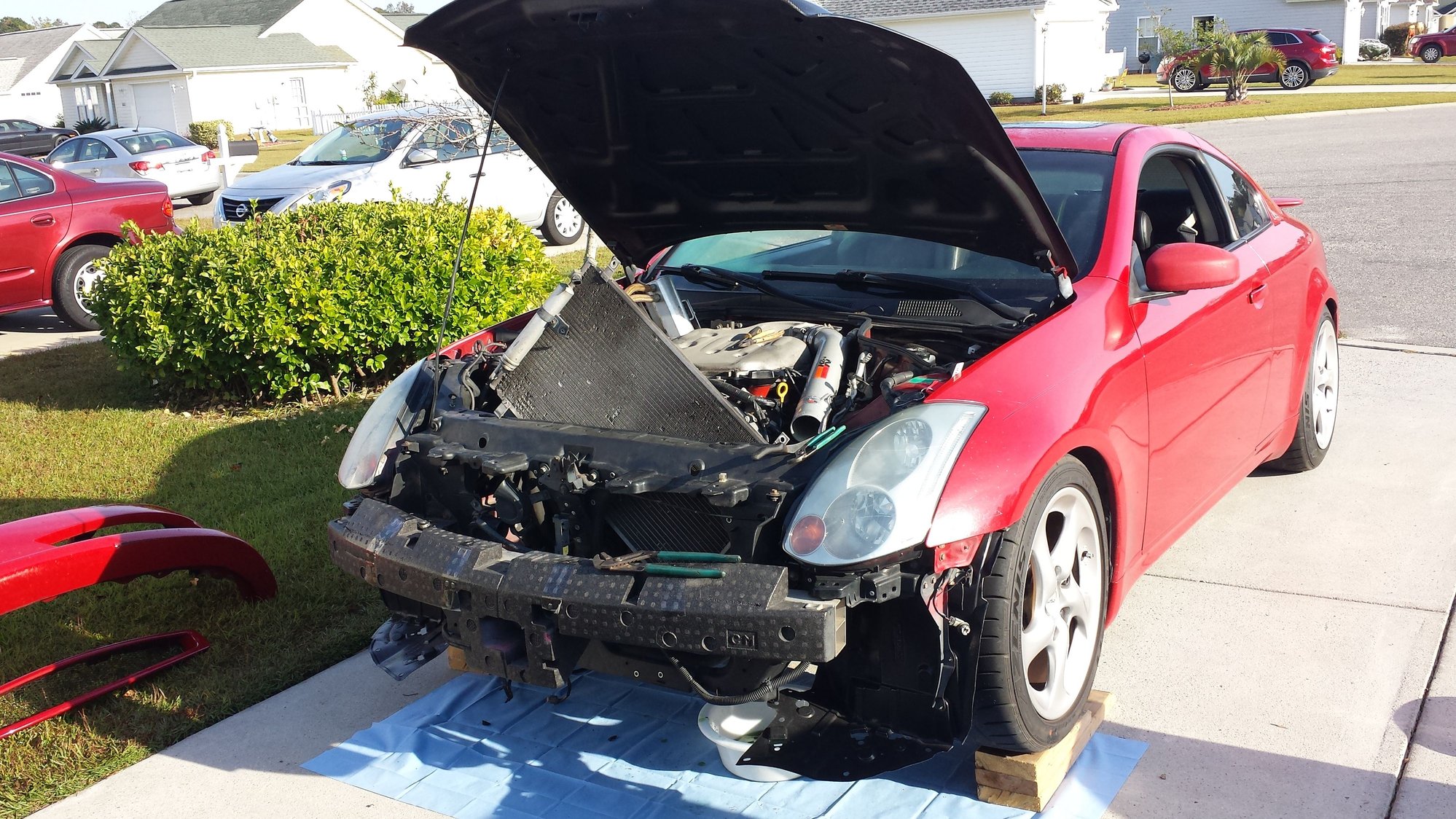

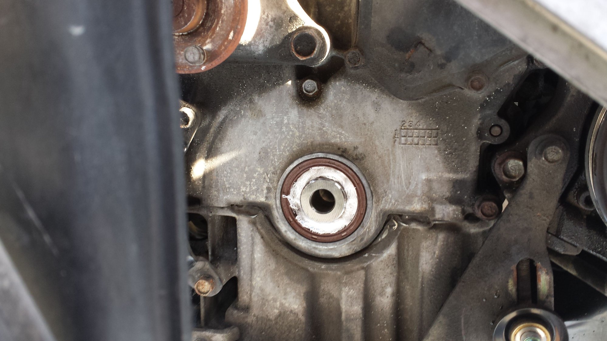

So Friday morning I decided that today was the day to knock out all my parts that have been collecting.

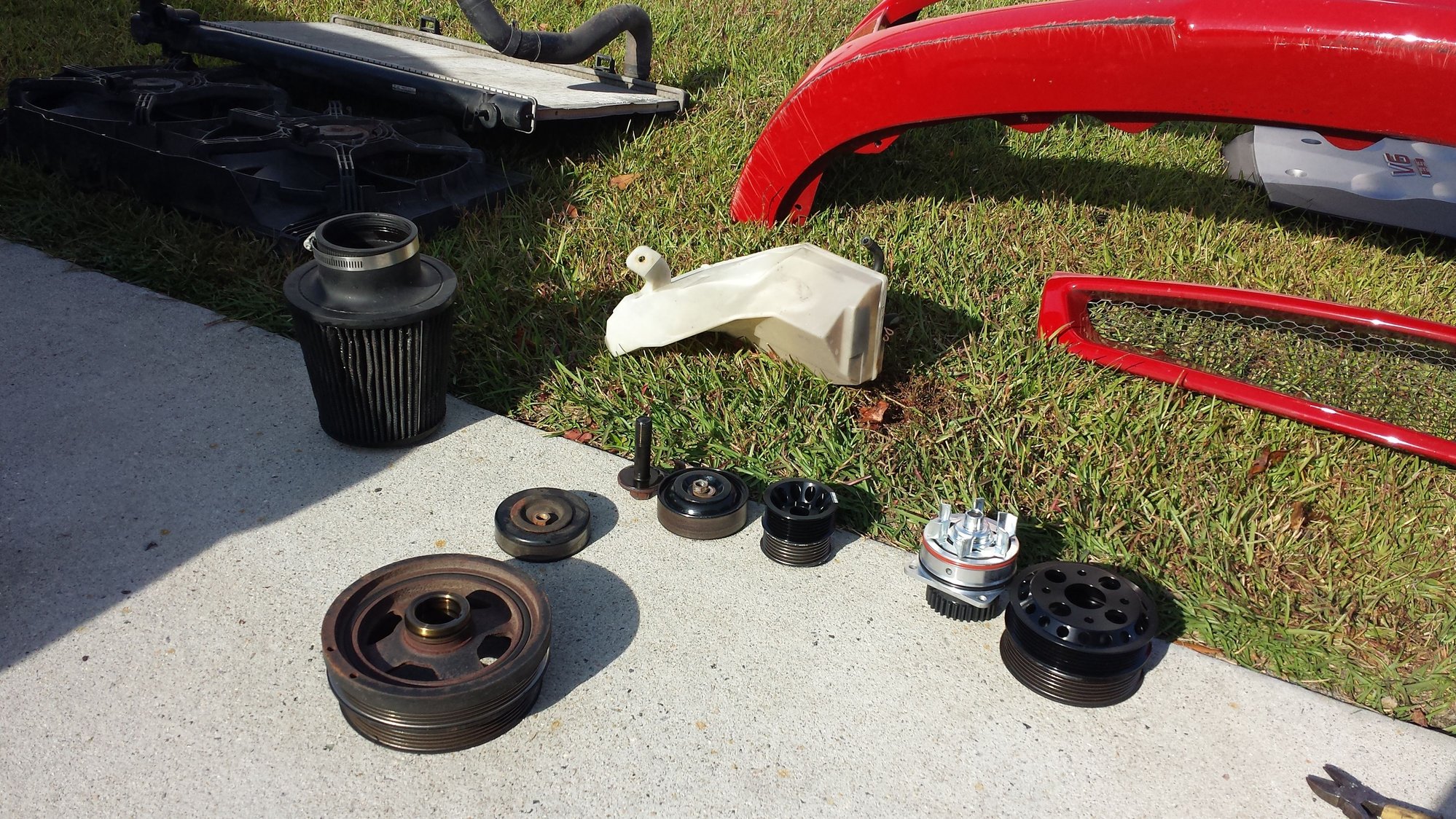

New Denso radiator, oem water pump and thermostat.

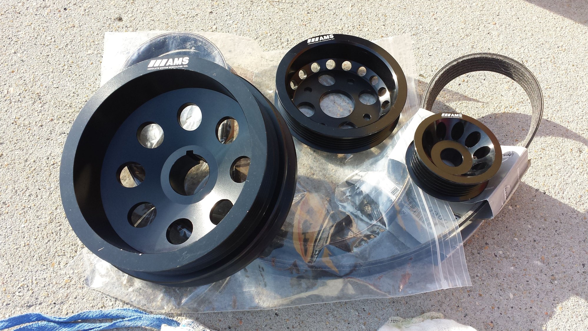

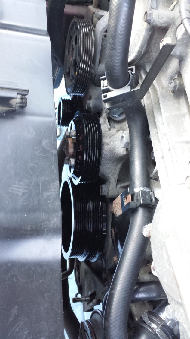

AMS light weight pulleys (crank, idler and alternator)
Front crank seal
Grille painted and installed in the Inven front bumper.

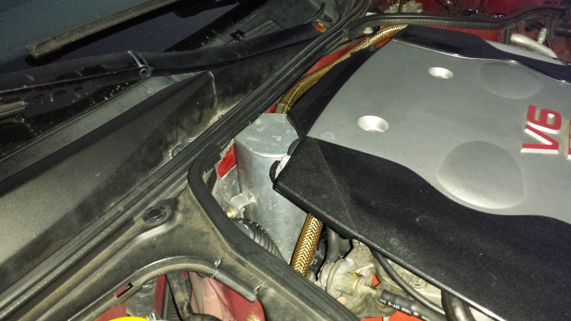

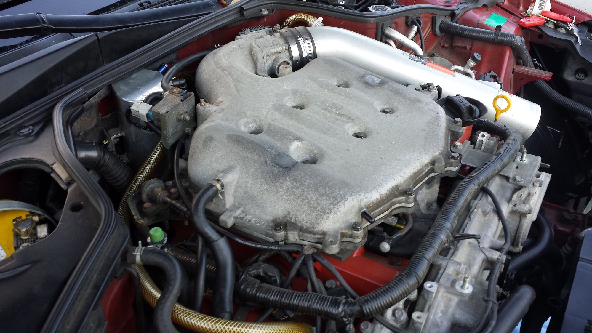

Also installed the lower cold air extension on the K&N Typhoon intake, and relocated the GReddy catch can to the rear of the motor on the passenger side. The look is much less cluttered now.
The AMS pulleys are OEM size, so not underdriving any accessories, but about 1/4 the weight, except for the crank pulley obviously. I wish I had weighed them both before installing. The result in lost rotational weight gives back the hp that was being used to carry the weight. I'm keeping a close eye and ear on the engine bc of the removal of the harmonic balancer. No issues or resonance thus far.

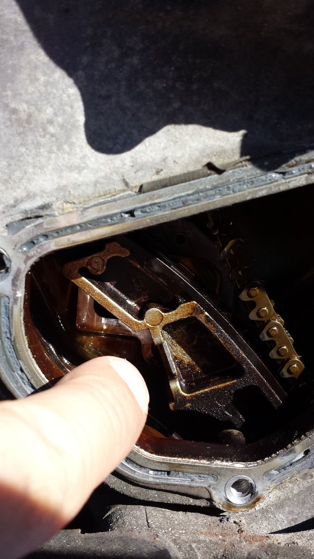

This little piece of plastic will ruin your day. The shoe for the chain guide and the timing chain tensioner. I broke a tab off, luckily it popped out and not into the timing cover. Luckily again I have a local buddy that drifts a G sedan and had a few spare engines. The one I got from him looks much newer and far less worn than mine.
The piece goes here.
Tucked nicely in the back
Pays to read the FSM for the procedure you want to do first. I know this but, should have done it long ago to be prepared. The top pulley I thought was the water pump, it is just an idler. The WP is run off the timing chain. Oh well..done now.

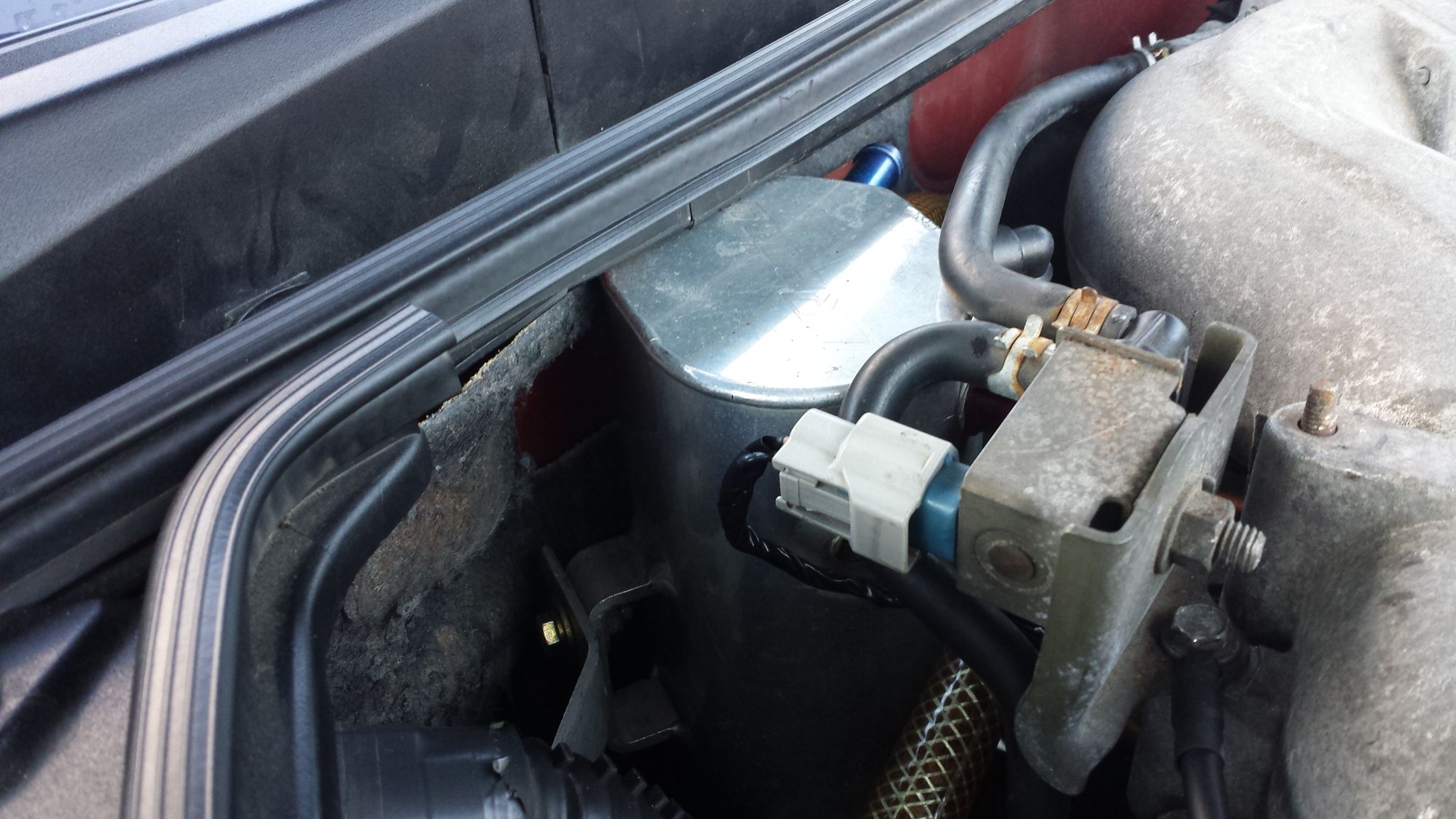

Fits perfectly, no trimming and a simple bracket. Same lines off the valve covers (PCV on passenger side, and vent on rear drivers side) and one out to the intake.

Nice work. Why did you HAVE to replace the radiator? Was it spent?

The radiator and everything else on the car is almost 14 yrs old and 126k miles. Plastic tank radiators don't last indefinitely, especially in this climate. Also the fins had an impression of the fan and shroud from a past incident. I really don't know the history of this car, now I have records for it and the cost was under $150 for the radiator, water pump and thermostat. Going forward it is one more thing I don't have to worry about.

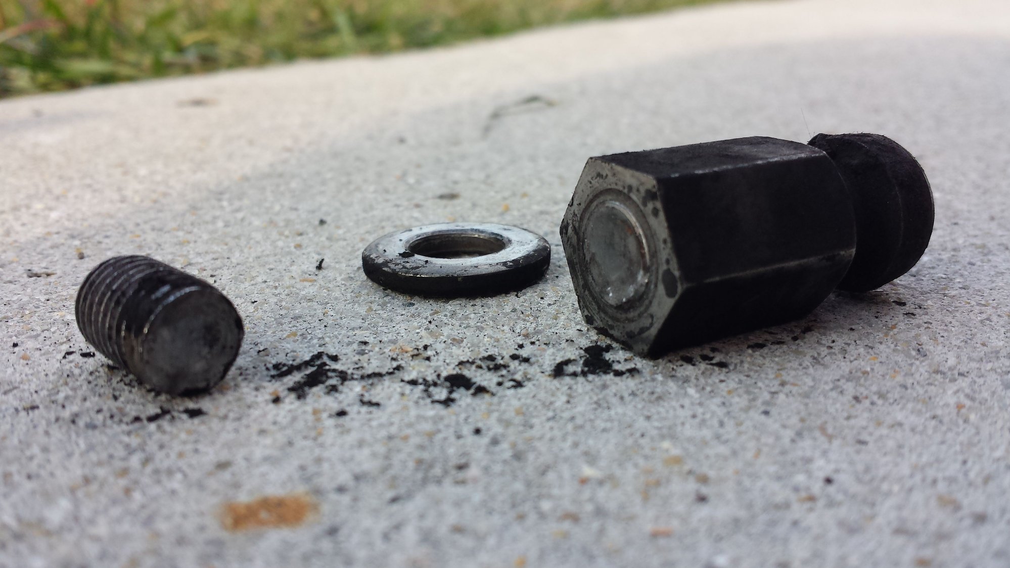

Son-of-a-b%&#@!!
This little sucker will ruin your weekend.
Clutch throw out arm pivot bolt
Old Nov 13, 2016 | 08:12 PM
  #86
EPiK's Avatar
Joined: Oct 2015
Posts: 703
Likes: 53
that clutch fork pivot bolt .. i'm now renting a car for the week
going in this next weekend
2005 G coupe CD009 6mt
new rear main seal (while you are in there)
new throwout bearing for the CD009 trans
new clutch master and slave (slave shot out when the pivot broke..and it's old)
chromoly pivot bolt
going to be a busy weekend coming up.. weather had better comply with my wishes..it's pouring right now outside.

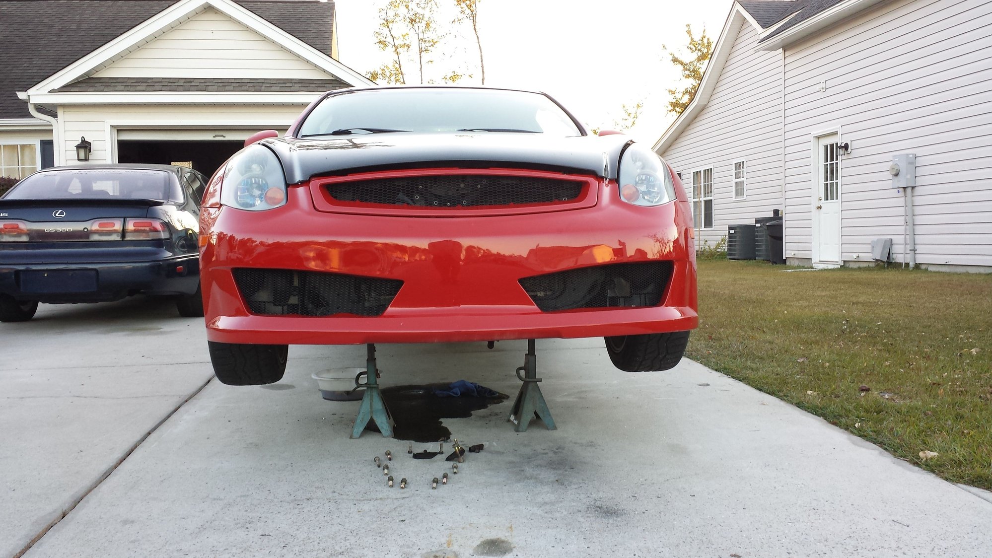

welllll... that's been awhile. big discoveries, big changes..and injuries. full story and pics later. the coupe is still on jackstands.
Old Nov 30, 2016 | 09:33 PM
  #88
EPiK's Avatar
Joined: Oct 2015
Posts: 703
Likes: 53
And that is how she has sat for about 3 weeks.
