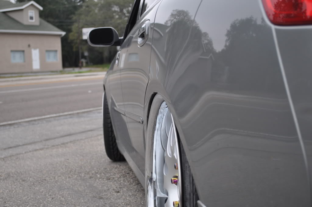

here is the rears cut and you can see the tire is so damn close to the fender but i clear PERFECT and then when the rim gets close to the fender i have the camber set to where it just barley clears the cut lip .. i did the compress test and everything and maxed the whole rear end down as low as i could make it and everything was so damn perfect

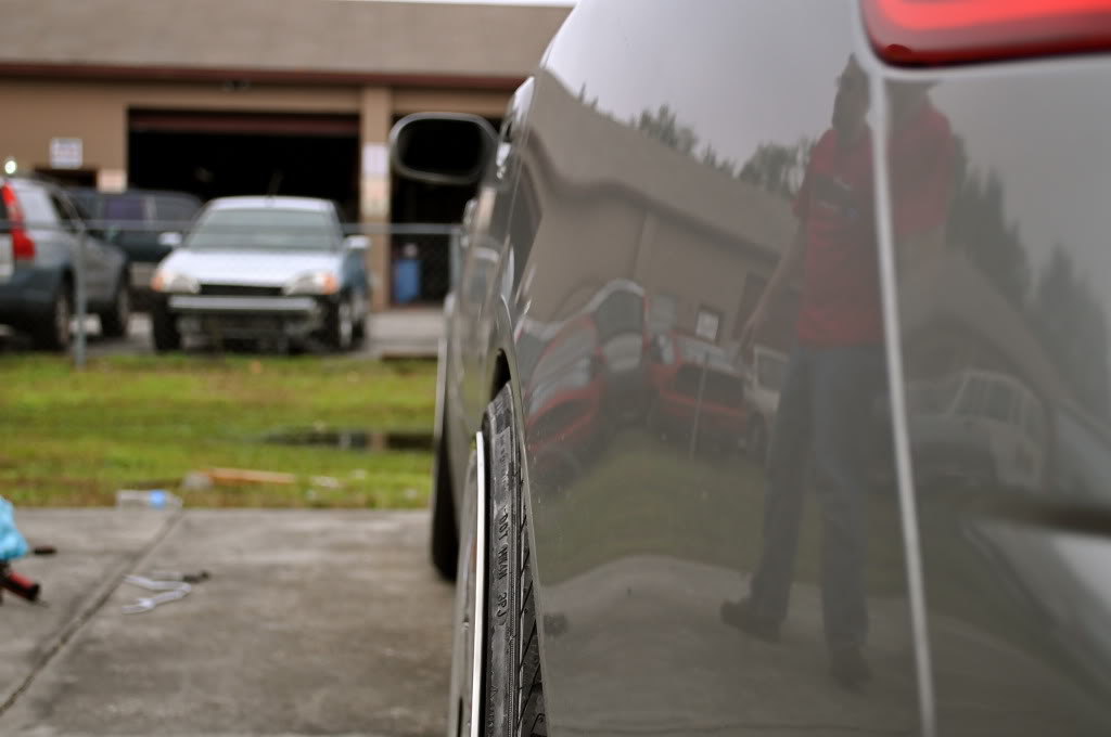

here is a picture to show you my tire to fender gap at a little compress i clear by about a credit card or 2

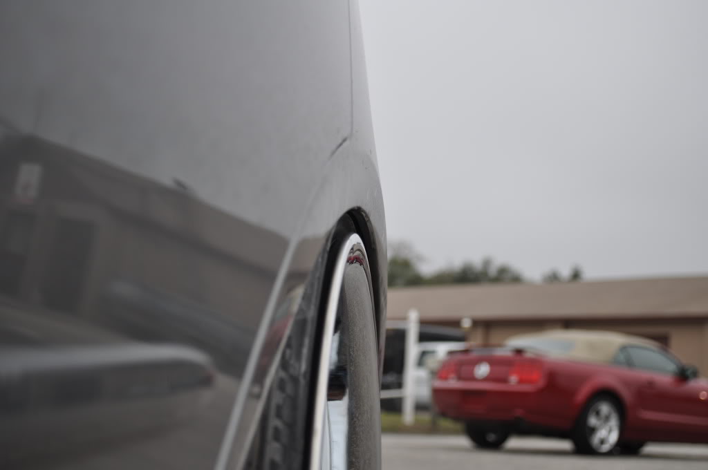

and then the rim tucks by a bit

because my rears were cut i took extra time to get everything " PERFECT " just so i wont hit the cut edge ... took almost 7 hours or playing with the height and camber to get it good without rubbing

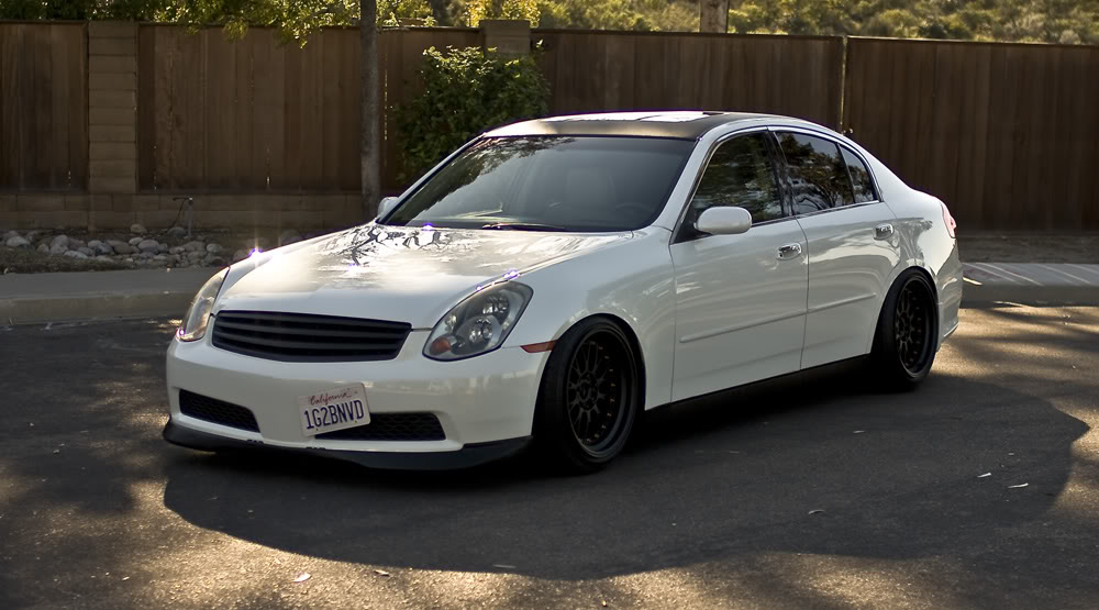

Update: Finally put on the 03-04 skirts I got from Vivek about a year and a half ago, and added an Ionic OEM front lip. Both are unpainted, the flat black ties in with the wheels and grille nicely
