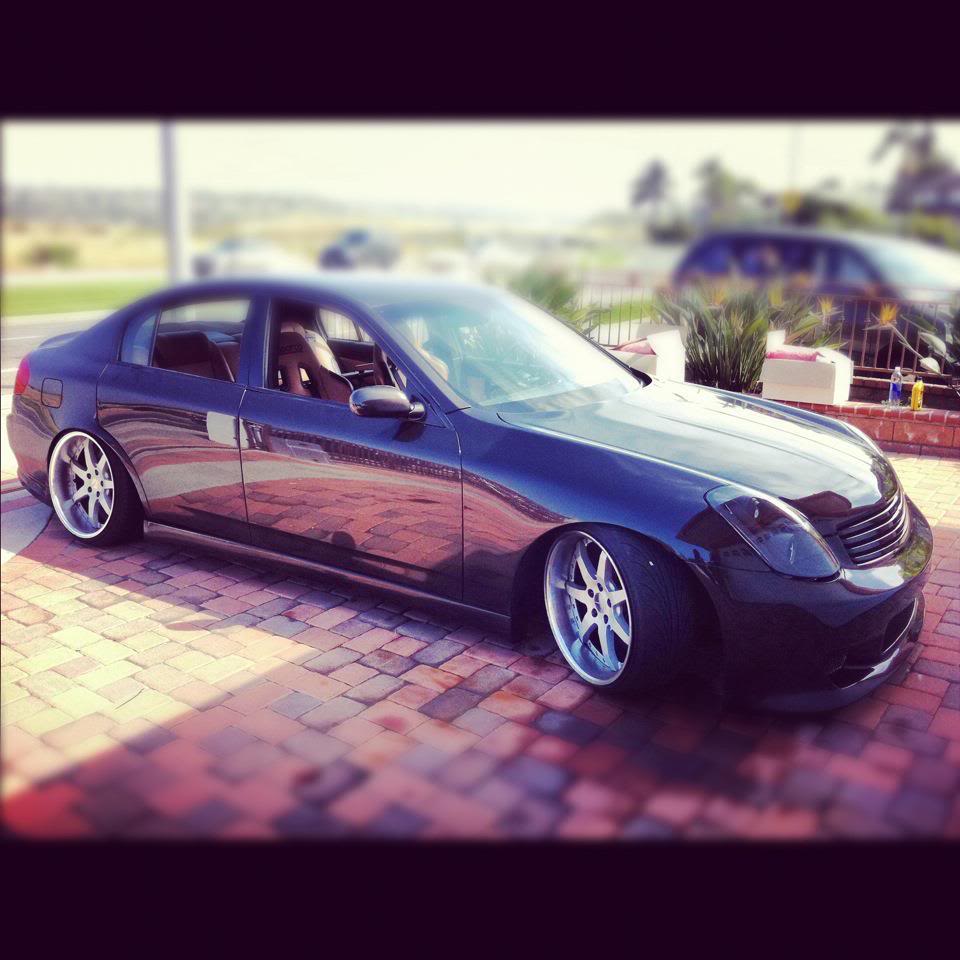

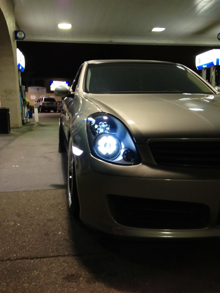

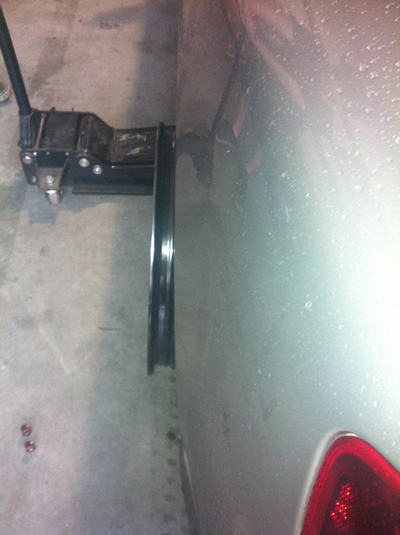

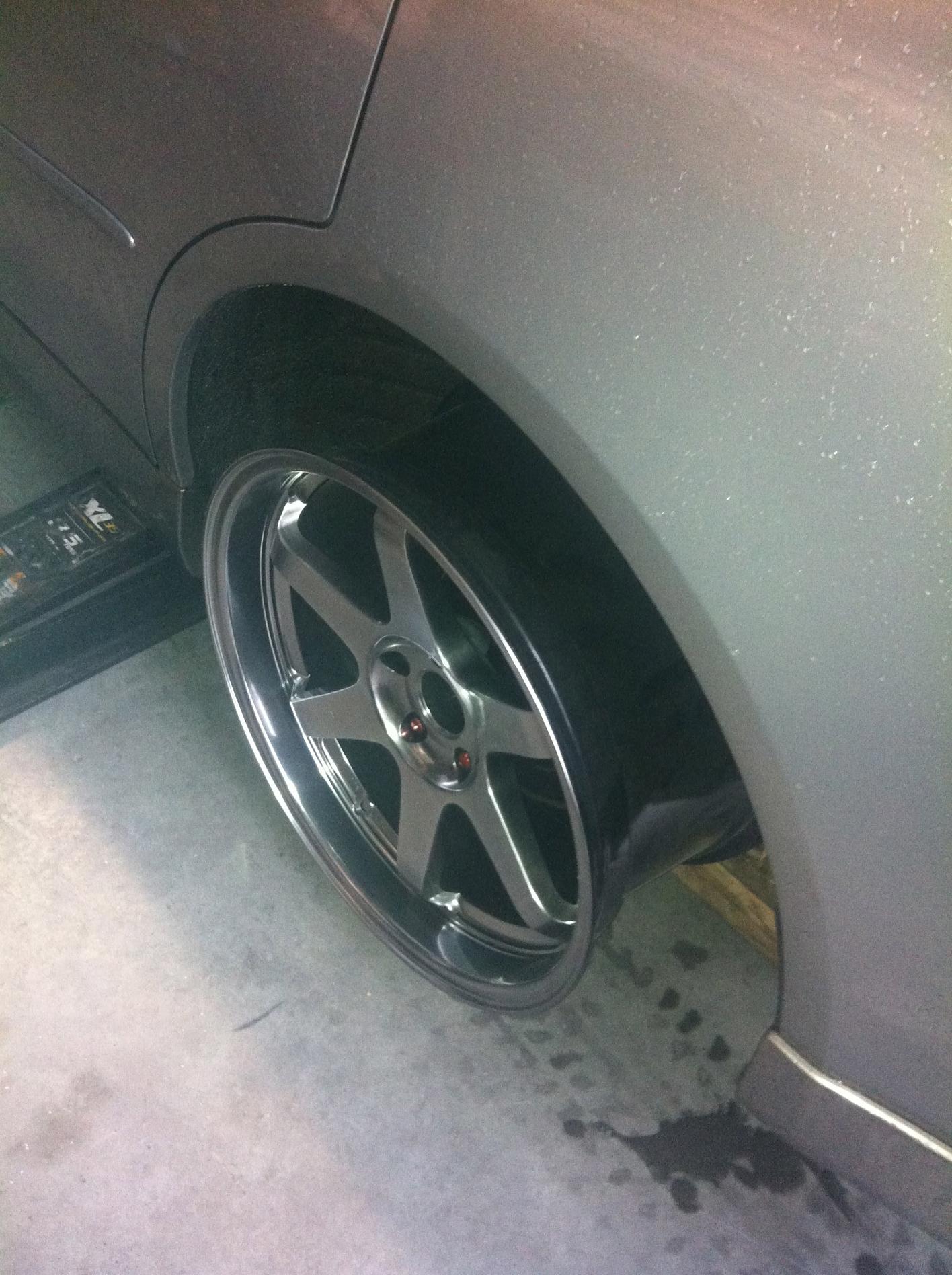

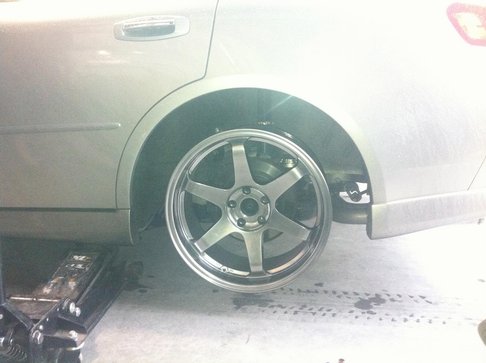

What do you guys think? will it fit?
fender pull? how much camber?
its a 19x10.5+12. just jacked it up and put it on to see......
Attached Thumbnails OFFICIAL: Aggressive Wheel fitment FLUSH/STRETCH sedan-img_3955.jpg   OFFICIAL: Aggressive Wheel fitment FLUSH/STRETCH sedan-img_3956.jpg   OFFICIAL: Aggressive Wheel fitment FLUSH/STRETCH sedan-img_3957.jpg
Old May 17, 2012 | 10:52 AM
  #5616
CandlestickPark's Avatar
ill Sedan
iTrader: (87)
Joined: Jun 2007
Posts: 23,261
Likes: 2,688
From: Long Beach, SoCal
^Those will fit. Per your PM you said that you were planning on running 235/35 tires. You can fit those with a small pull (3-5mm) and around -5.5 to -6 camber. For every additional 5mm you pull your fenders you can add back about a degree of camber.

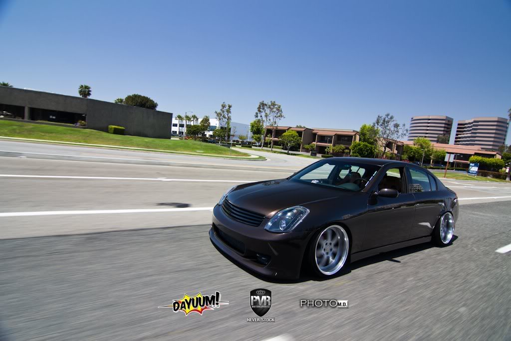

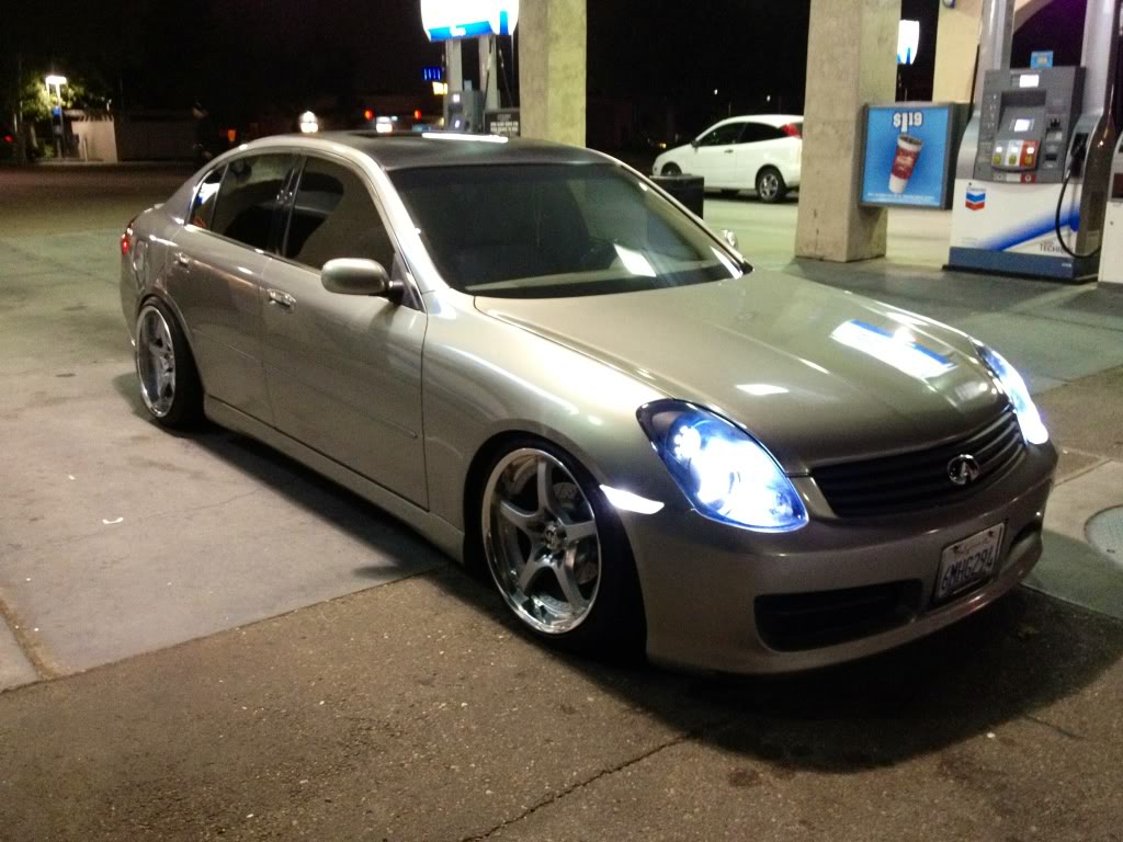

rolling shot
THANKS!!!
yea.. really don't want to pull fenders bc its pretty much permanent... and don't want to run that type of camber... since I'm a AWD and i used it daily...
BUT!, i just ordered 19x9.5/10.5+22 running 235/35 all around! 6week back order on that size and offset for Hyper Black.
oh well its the only wheel i want especially at that price range..

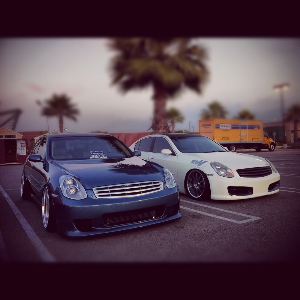

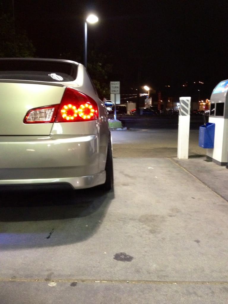

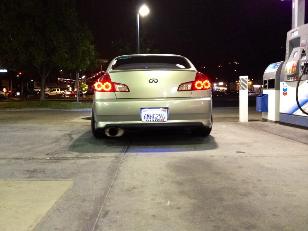

I know I never post anymore but here's my setup before I get rid of them.
19 10.5+23. 9.5+28
