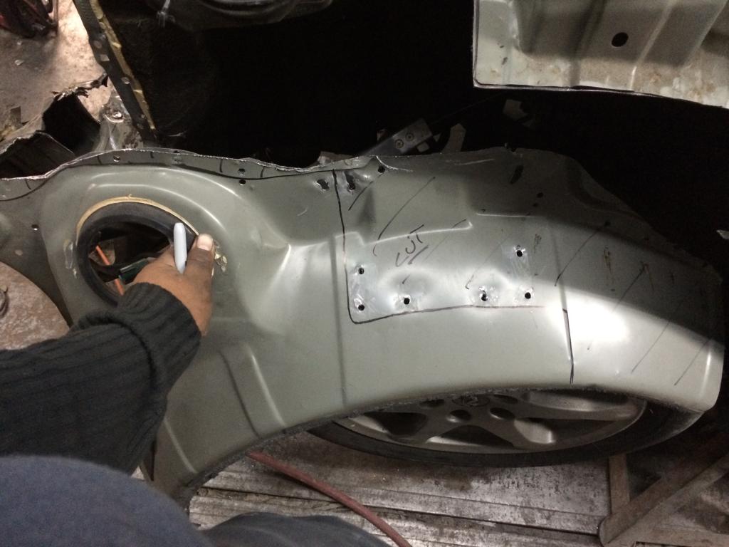

Well I'm back with some more updates... Here's what I did today.
After pulling and I saw that it didn't come out quite right I cut out this section and started replacing it.
Marked line of the area to cut...
I removed this from the rear clip I bought.
Area ready to receive the new part.
That looks like crap!!
And the new part getting marked to be cut.
And I also started cutting down the chassis to replace it with the one from the rear clip
That's today's progress, tomorrow I'll do It again and hopefully I'll be able to weld the part.

Ok so I made some progress today... No day off for me but car is taking shape.
Much needed break of the day!!
And more work...
Spare tire floor is in.
And test fitting the new quarter panel and fine cutting.
If you look close you'll see that the quarter panel sits on top. I was taking measurements and fine cutting to make it all fit properly.
Test fitting the trunk.
And that was pretty much all for today.. Believe it or not it took me the whole day from 10 am to 8 pm to get to this point and yes everything is being held by screws because it's not properly aligned. Next step is to have everything align properly including tail lights and everything and once I'm sure it all fits properly I'll move on to welding the whole thing. If you guys have any questions please feel free to ask them and if you have any suggestions don't keep them to urself!!
And as usuall... I'll keep you guys posted. 😁
