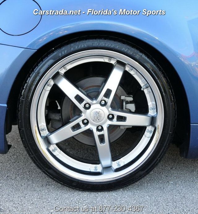

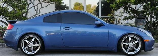

yea i thought about that too.. but i bought it from a dealer near miami florida. and i dont know what i have..
i deff need a camber kit and new tires for the 20s that came with the car.
the rear sits a little higher than the front... i think i want to fix that..
anyway... i need to buy new rims and tires for a winter set up soon, but i also need new tires for these rims for when it starts getting nice again.. these tires are shot!
im only 23 with a little bit of experience from working on my past 2 cars.. modding my civics. yea i know nothing like a G! and i dont want to make my problem worse.

The camber kit's are just a replacement bolton. Pretty simple, get PB blaster, correct tools, and put aside a good amount of time on the car. There are some DIY here you can look around to do the camber install.
As for the rear sitting high G35's are normall raked but you can cut the rear rubber spring mount (You will know what it is when you pull out the springs in the rear) to get it even. There is also a DIY for that aswell.
By the way, you can look under the car to see what springs you have. Usually they have a logo written on there just inspect the springs.
