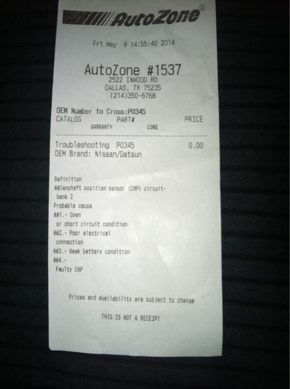

The first time I went to Autozone my battery tested as bad, so I had it replaced. My car would still die so I went back up there to test my alternator and they said it tested good. I had them plug my car in and here is the printout

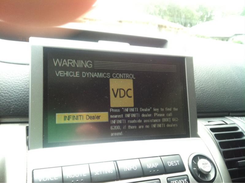

Every single time it dies when I'm driving this pops up

Find out what sensors were replaced and demand OEM sensors and not aftermarket. Check your brake fluid level.
P0345 Camshaft Position Sensor 'A' Circuit (Bank 2)
P0345 = bad driver side cam position sensor (left hand side)
https://g35driver.com/forums/showthr...hlight=Jin22gt
http://forums.nicoclub.com/p0345-cam...e-t516380.html
http://my350z.com/forum/engine-and-d...345-issue.html

You were right, it was both camshaft sensors. The place I got my car claimed they had replaced them, but obviously not. I ended up taking it to a reputable shop pretty close. Total cost was around $280, I don't know if that was average or what.
