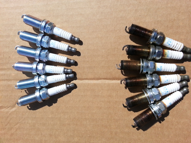

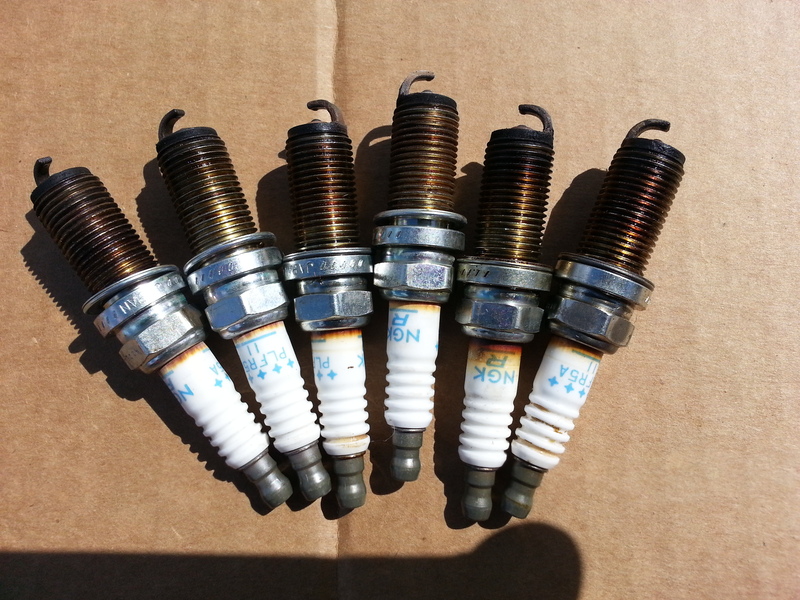

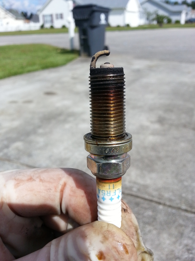

check out these plugs

one more question, what do I order, and any suggestions where, to do the valve cover/tube seal gaskets. Do I need a plenum gasket set as well?
