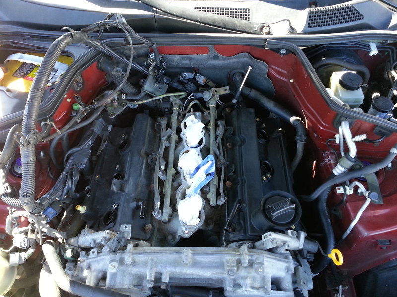

Continuing a part buying spree, i have a fresh set of motor and transmission mounts on the way. All should be hitting my door about the same time, Thursday this coming week I hope. I decided to do the mounts after researching the header install and finding that I will most likely be lifting the motor anyway. No biggie, I have a hoist.
This might solve a few issues too.. shifter shakes a bit more than i would like driving down the highway. i think the longtubes are vibrating off the floorboard sometimes when i get on the gas, especially in a turn. Mounts should clear that up if so, not to mention losing the longtubes anyway
Long list for that day so far, but manageable if i plan it right.
-remove upper plenum, TB
-remove coils
-loosen/remove mounts, lift motor and suspend. loosen old longtube headers
-loosen steering column knuckle
-remove old headers
-reinstall new (used) headers and cats
-install new mounts and drop motor back down
-remove valve covers, clean, install new gaskets and RTV
-reinstall coils
-clean all grounds that I can see and reach (learned this from the Porsche)
-clean TB, MAF and plenum, reinstall
-attempt to complete the reset procedure for the ECU/TB/Idle..etc probably til I'm blue in the face.
hopefully this all goes according to plan. i do know that i need to pick up some gaskets for the headers and cats yet. and some bolts that I think are missing from the headers onto the head now.
*fingers crossed

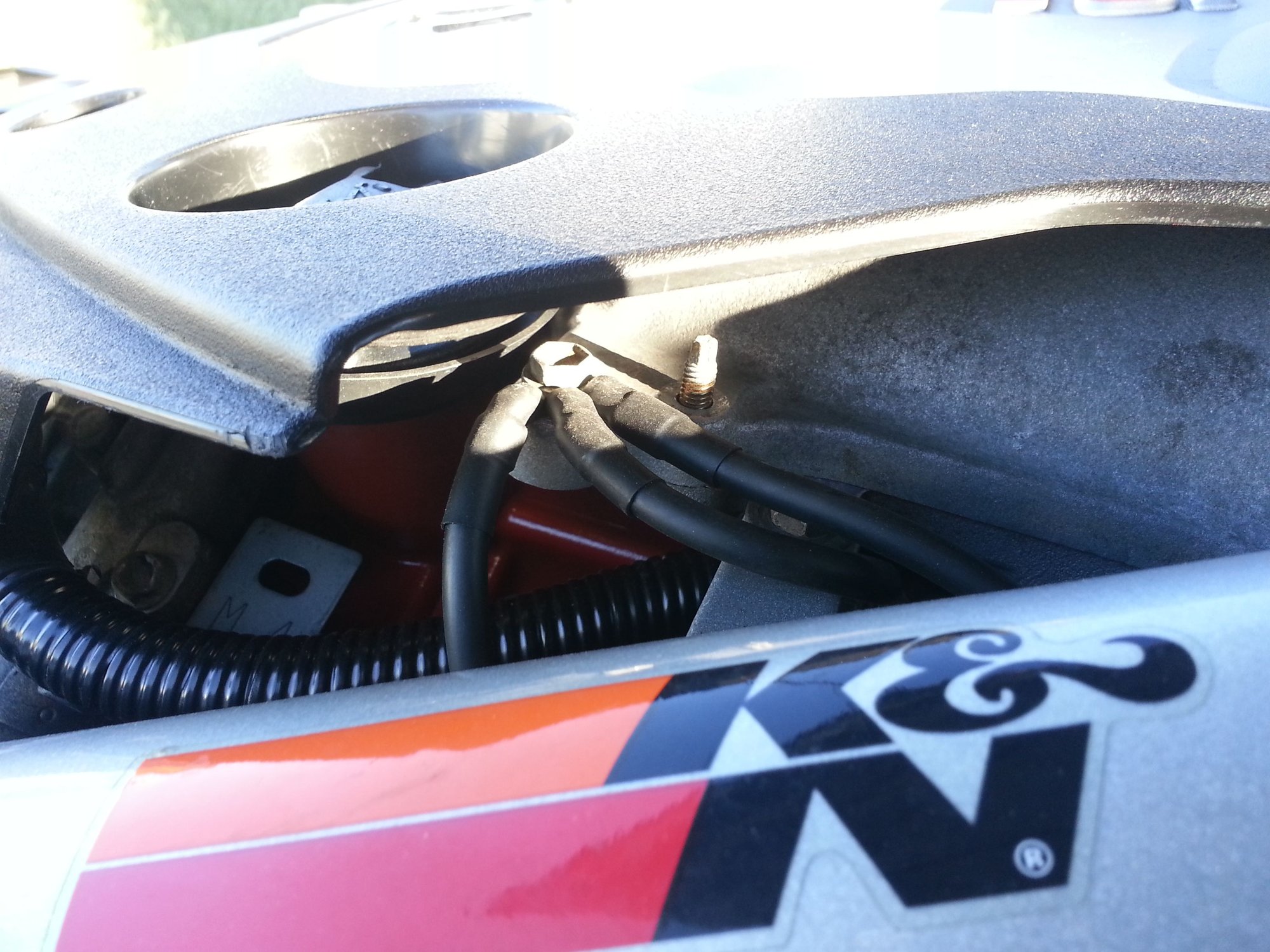

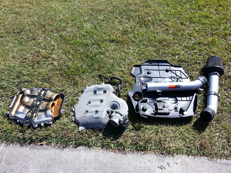

so, Thursday was NOT a good car day. Turned a simple job into a 2 day event. Ran into things that I did not expect in a 12 yr old car.
I snapped a valve cover bolt off removing it, almost 2 of them but I wised up and tapped on the head of the bolt to shock the threads and sprayed that one first. Luckily the one that I snapped off was the passenger front outer corner, so it wasn't impossible to get to. I wasn't able to extract it though, so it is now drilled out and replaced with a nut and bolt. As it was, I spent over 2 hrs on something stupid.. no mounts.
Then there was the 2 hrs spent trying to get the freshly painted valve covers back on without the new gaskets falling out. I tell you, I have worked on A LOT of cars..of all makes.. this one made me feel like a noob. Maybe it is because I had been up since 3pm Wednesday, worked all night and stayed up Thursday to work on the car..finally getting the valve covers re-installed at dark. I did get the new cam position sensors installed though.. while I was in there.
I finally got back to it on Friday afternoon. I cleaned the TB, upper and lower plenums. I cleaned the gaskets and sprayed them all with copper gasket, just to be safe. I had been hearing a vacuum leak and the only thing in the area was the PCV valve, so I put a new one in. A little better, but I think the PCV hose needs replaced now. I think I'm going to fab a catch can, since the inside of the plenums was pretty oily.
The thing I'm upset about is, there has been no change to my stumbling idle and it even stalled on me again coming to a stop.
I have several exhaust leaks in the midpipe, they actually whistle on decel, my dad said (in all seriousness) that he thought it was the turbo spooling back down..lol Wondering if those leaks are so severe that the O2 sensor is tripping out and running it rich. I also really want to get a spare set of injectors to send out for cleaning. Smelled a lot of gas when I opened that plenum. I think the injectors are seeping/not atomizing properly. I have already run seafoam and techron thru the tank. The TB was actually pretty clean.
So I'll be buying a midpipe, not sure if I want the same style that is on there now (Ebay..manzo brand looks like it) or the more than twice as expensive Circuit werks resonated one. I want it quieter I know that much. The headers may be a hefty job by the look of just the top end work so far..

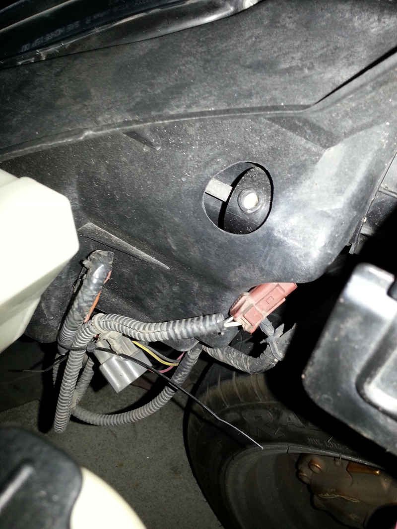

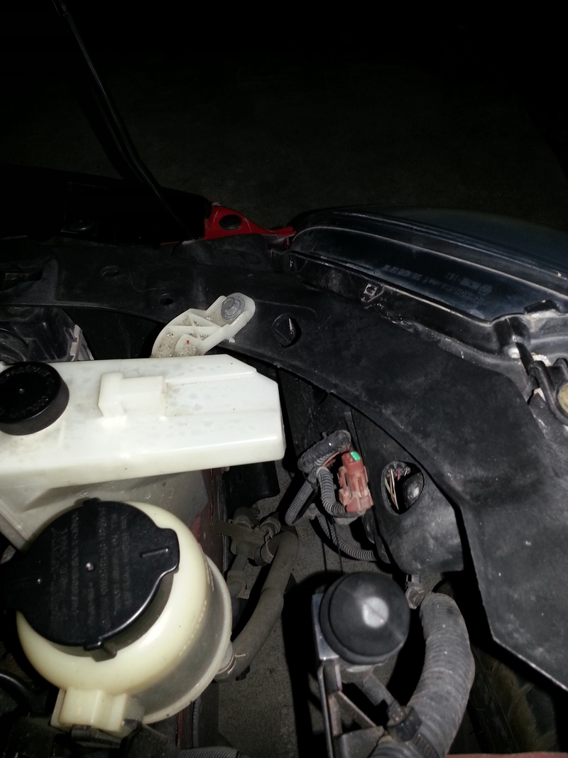

also..trying to figure something out. what am I missing in these pics.. that is the passenger headlight area, by the overflow tank. these plugs are zip tied up

I'm sorry to hear its going so bad. Did you clean the MAF tho? 99% of stalling on these cars is one of 3 things: dirty TB hinges, dirty MAF or cracks in the intake tube (unmetered air) between the MAF and TB. The ziptied thing looks like the plug for the headlight. You may have an aftermarket ballast/igniter setup.

I figured out the mystery of at least one of the plugs in the pic. Windshield washer fluid bottle. It's not there. Anyone have a spare to sell?
