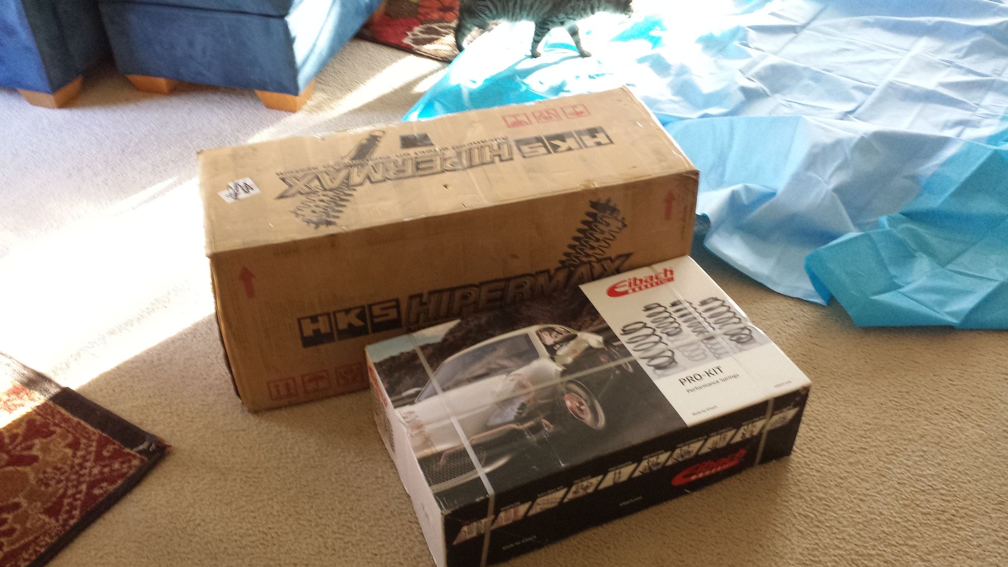

I got the Bilsteins and Eibachs today, but stupid DST has it getting dark so early that all I had time to do was assemble them.
Tomorrow they should be on the car. I'll measure the wheel gap and height on the D2 before removing them, then the drop on the Bilstein/Eibachs and then again in a few days when they settle. I also borrowed an Eastwood fender roller to roll the lips just in case. Pretty sure I'm going up to 25mm spacers up front.
Stay tuned...speaking of which, I need to get a tune pretty soon.
Just an hks box, the bilstein are in there
Lol...engrish
