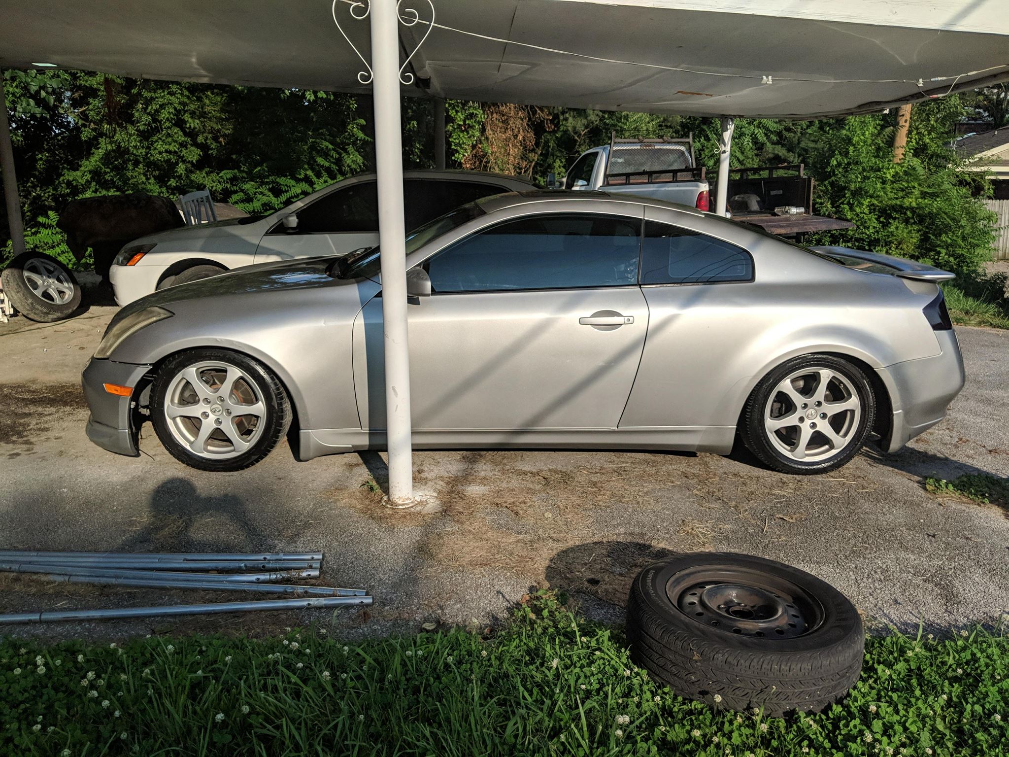

Hello all i just purchased my first G35 last week and while i HAVE owned a Nissan before (a 1993 Maxima SE 5MT back in 1999) I had never owned one since and last week found a deal and decided to take a chance on it. For a couple of months there were 2 cars sitting at my local Credit Union that had been repossessed, one being a Silver 2005 350Z with 118k on the odometer and a Silver G35 with 181k on the odometer and both had a sign in the window saying "Make us an offer". I decided to inquire about them and was told both had dead batteries but if i had jumper cables they would bring the keys out to me and let me look at them. I was more interested in the G35 since it had rear seats, and all the seats looked perfect except for where your butt goes in the 2 front seats and the dash had some cracking around the clock area (im assuming this is normal for them?) anyway the G35 cranked up but had some ticking for the first 20 seconds then completely went away and would rev very nicely. body looked good, only had some clear coat coming off on the tops of the side mirrors, and evidently it used to have rims on it as it had been lowered and when the previous owner knew it was going to be repossessed he quickly pulled them off and put some cheap steel wheels on, apparently from an Altima or something would be my guess. Anyway i decided to shoot the moon and throw out an offer of $1200 and they accepted it! I was able to start it and drive it home. Found out quickly that the gas gauge didnt read correctly as it still said it had 1/4 of a tank of gas in it yet died and wouldnt start again until i put more gas in to it. The top picture is after removing the steel wheels, the second picture shows the back of it when it still had the steel wheels on it. I ended up going to a local "Pick a Part" yard and found a G35 Sedan with good 17'' wheels and tires and bought them and put them on to get rid of the steel ones. Then i took a saw and cut off that ugly pipe sticking out the back (No idea why they changed it to a single tip but will be going back to duals ASAP.
So i have only had it for a week and it has way more power than i expected it to have for a $1200 car lol. Wife wants it to take kids to and from school with =/ will have to talk about that one...
There are only a few things on it that need to be remedied, the Sunroof will tilt up but not slide open, the radio controls on left side of steering wheel do not work, Traction control light and slip lights came on the other day and havent gone off, Airbag light is flashing (but car has never been wrecked or had the airbags blown.
Hopefully still not bad for a $1200 car that looks great with no body damage that runs like a scalded dog. I do expect that i will need to put some money into a few things though. So far loving the car.
