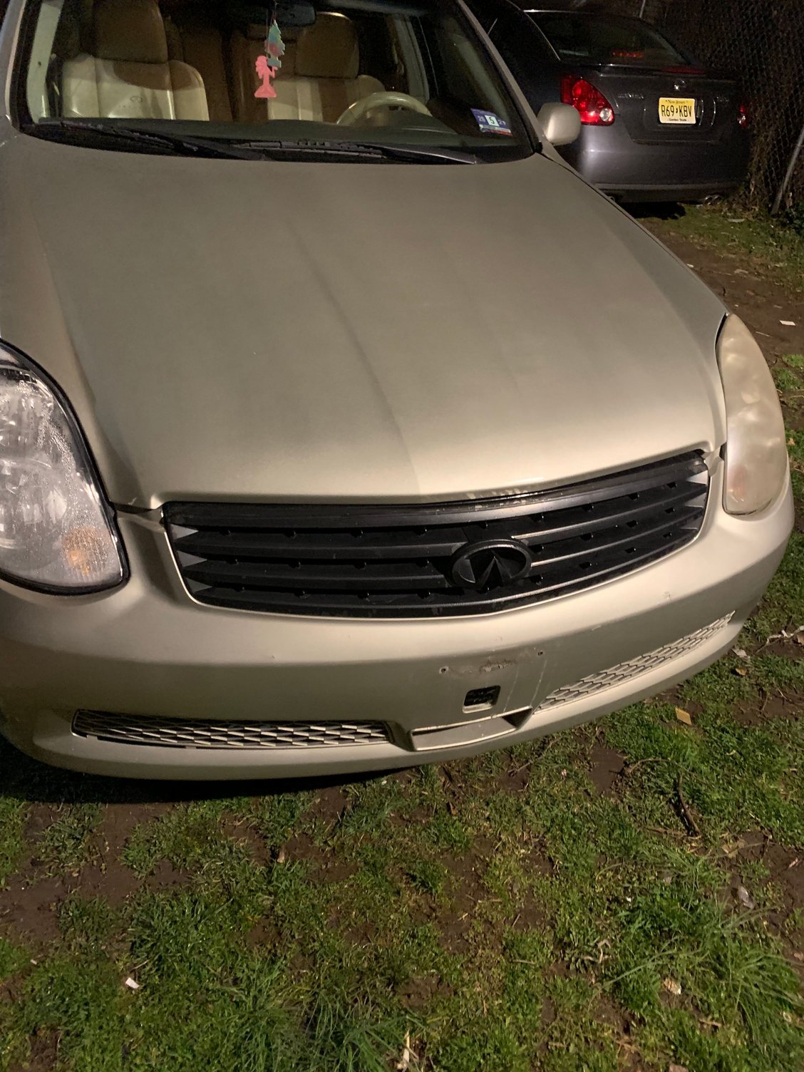

Hey I have a G 35X 2005

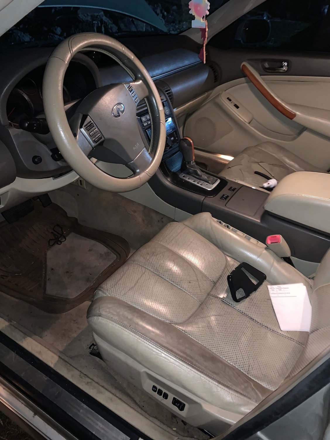

I need new seats also and middle trims
Side lights
my catholic converter is clogged it smells like gas all four windows don’t come down it has about 160,000 miles my lighter fuse keeps burning
