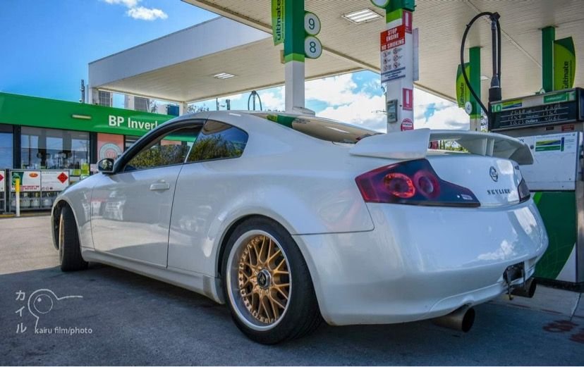

Pics and build
How I got the car:
2003 Premium V35 with sunroof
  • 6sp Manual
  • Brembos
  • Work VSXX
  • Nismo sway bars
  • Nismo Rear wing
  • Fujitsobo exhaust
  • Ancient Tein Flex coilovers that must have been installed back in japan
