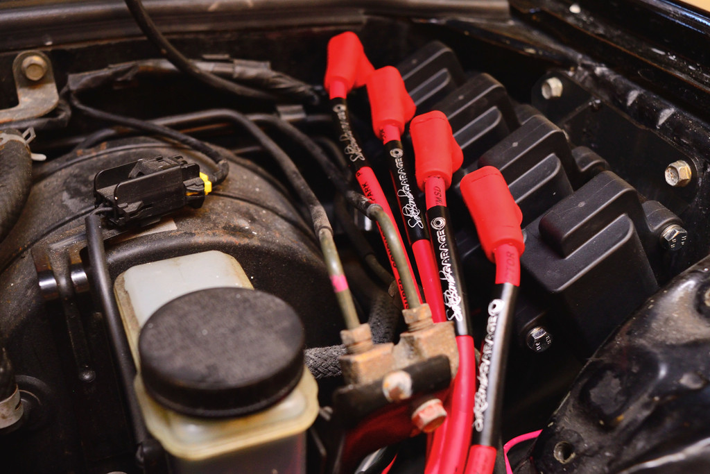

The stock ignition coils are kind of unreliable and are known to fail prematurely. On top of that, they're tucked away under the intake manifold, soaking up all the heat produced by the motor.
So I looked around for an alternative solution and the options I found were...meh.
And then this setup popped up...
AEM smart coils with a custom bracket to relocate them away from the engine and out of the elements!!
Made by SakeBomb Garage. I just got my tracking info today. So it should be sitting at my doorstep when I get home from AZ on Friday!

I realized that the Daikin pressure plate was just an OEM replacement and would not hold the power I am shooting for. So I bought an ACT extreme pressure plate and threw it on.
My SakeBomb Garage AEM Smart Coil kit came in as well.
I installed the transmission, drive shaft and power plant frame to finish the powertrain portion of the rebuild and hung my Tanabe Medalion Touring muffler.
I then assembled all of my fluid hoses for my fuel system and turbo cooling/oiling. Yes I will be getting a turbo blanket and some heat shielding for my hoses.
Next, I finally got a chance to trade hoods with a friend of mine. He went with a different setup and will no longer need a drop vented hood...and I need a drop vented hood...so...BOOM. I love this style of hood!
So since I got the hood, I test fitted my custom Greddy V-mounted intercooler and it just wasn't going to work the way I wanted it to. So I will be sending the entire intercooler/radiator setup off to Jason over at Rx7store.net and he will be modifying it for me to fit my duct
I want the intercooler to sit flat (parallel to the ground) so I can utilize the duct to its fullest.
I need to pull my dashboard back out and replace it with the better condition dash I bought for pretty cheap...but...It's too damn hot where I live to be fighting with that thing in my garage. So that is being put on hold. lol
So I decided to paint my "new" core support instead, and start routing my front chassis wiring harness back in the stock locations.
Before (Notice the mess of wiring on the ground.)lol
After (still haven't done the harness yet here)
After paint and routing the harness, I buttoned up the motor as far as I could without the power steering pump and a few other things.
And a few parting shots until I get back from out of state again
