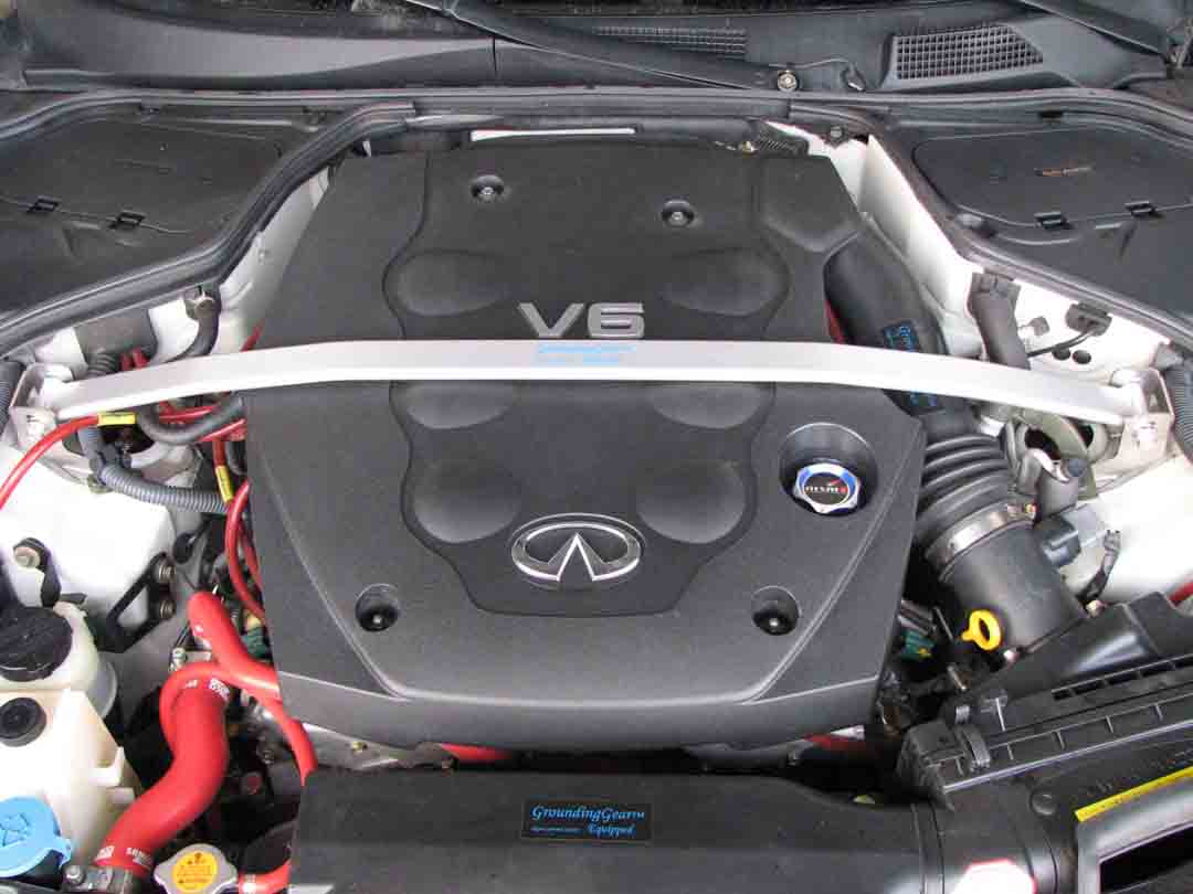

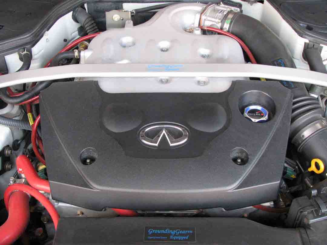

The Strut Brace was quite easy to install, with only a little bit of work getting the driver's side bracket under a nylon clip (on my 2003 sedan). No creeping of the ends of the bar in the bracket slots.
I already have the Stillen Sway Bars, and the Strut Brace seems to be a good combination with them.
A bit more linear response in the turns, and the car seems to track truer in turn transitions.
I initially tried mounting it over my stock engine cover, but with the 5/16" Motordyne spacer, it just wouldn't work.
I ended up modding my engine cover, and I'm very happy with the looks of it now. The looks of the cut-out for the intake tube resonator box always bothered me when used with the Z-Tube (also with other straight tubes, CAIs, etc.), but the little 'jog' looks good as a transition when the cover is cut. In fact, look closely, and you'll notice the other side is shaped to match!
I made a couple of cork spacers (glued to the underside) which sit on the upper plenum to make the back of the cover more rigid. I was going to make a couple of adjustable velcro mounts for the rear, but it doesn't look like it's necessary at this point.

The cover looks good Gord.
Old Apr 8, 2007 | 08:21 PM
  #79
caelric's Avatar
Joined: Dec 2004
Posts: 1,229
Likes: 42
From: Omaha, NE
Damn! Thats quite well done on that cut. I might try that; my engine cover fits, but yours fits and looks quite nice!
