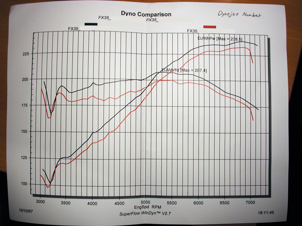

Originally Posted by gto-dave
First off, I commend you for actually dynoing this product and posting your results.
If you calculate out the average power across the powerband (4500rpms-7000rpms), you'll see that the little tiny blip in power from 6500-7000rpms isn't going to make any difference acceleration.
Without spacer
4500 160whp
5000 185whp
5500 208whp
6000 225whp
6500 228whp
7000 228whp
Average power: 206whp
With the spacer
4500 160whp
5000 185whp
5500 209whp
6000 225whp
6500 229whp
7000 232whp
Average power: 207whp

Ya, I see where you're going on this. It wasnt a big deal to dyno with & without spacer either, cuz I was at TS, & we were gonna tune the FX anyway. All that said, there is something to be said for the Butt-Dyno, & I'm telling you, you feel this spacer working. I'm not trying to sell this item, but those that have tried, like it.
I know my numbers overall do not seem fantastic, especially with the mods I have, But at least they are honest numbers, unlike alot of the BS found on the boards. My ride, although it does weigh in fairly high is pretty darn quick.

Thanks for the breakdown Dave.
But I have one question/comment. With gains as little as that, could that be acceptable variation in between pulls not just the spacer itself?
I definitely know it's doing something because my car is less hesitant (more responsive) at 2K rpms on the highway in 6th gear.
It's just with gains that are very minimal in that aspect, it's hard to say specifically that the spacer is what is causing the gain/loss.
The before and after difference could definitely be a variation in back to back dynos. It's a fact that these motors tend to show power increases over 3 successive dynos. The increases are minor (2-3whp), but they seem to be pretty consistent across most VQ35DEs that get dynoed. I know that with my old VQ30, I typically saw a variation of about 5whp between my first and last dyno. Most cars I've seen on the dyno exhibit the same thing. Turbo cars on the otherhand can show differences of nearly 20whp between successive runs. Heat soak and slightly inconsistent boost levels between runs account for that.
