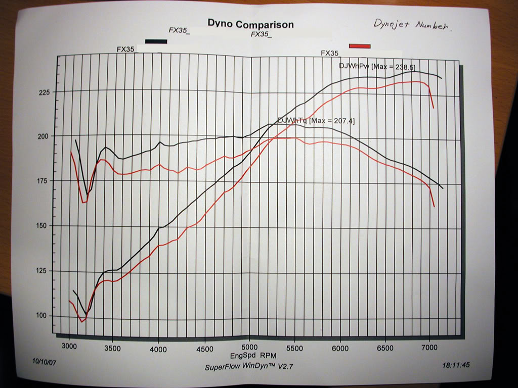

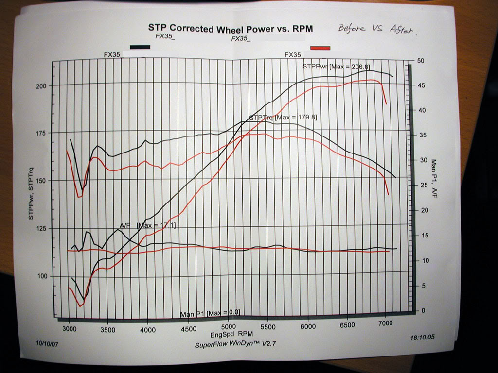

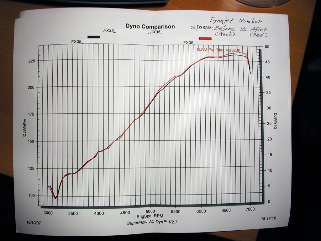

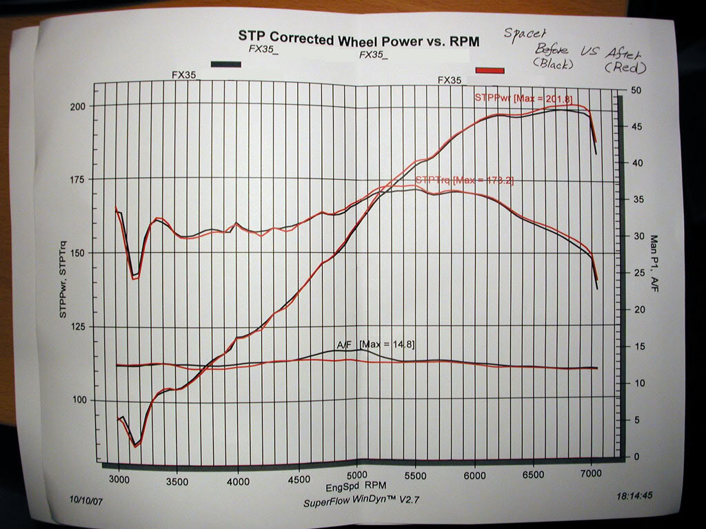

Turned out my TB got messed up somehow. The sensor inside is off, & it idles too high, throwing the CEL. Was at TS today gettin tuned up, & Tadashi was scratching his head on this one, cuz the TB wasnt throwing any codes. We tried with & without the TB spacer, & came to conclusion that the spacer is not at fault. I suggested we pull the TB off his project drift car, an M, from the side lot. Reinstalled, & problem fixed.
So the results . . .
TB Spacer without tune, gave me 6 or 7 hp, & a lil' bit of midrange torque with no loss, so my guess is it cant hurt to have one. It does alter the A/F a bit before a tune as you can see below. After the tune, I cant really say what additional gains were made, but here are the sheets anyway.
I didnt notice anything on the buttdyno, cuz it's obvious the gains are not huge, but probably more collective with my other mods, but it does make a really cool whizzing sound. Intake has a really neat spooling up sound.
This is before any tune during our trouble shoot test
After Tune w/ Reflash (we were able to fix the A/F with the tune)
Keep in mind that the sheet above reflects my mods plus spacer, and never been tuned. Sheets below reflect my ride after it's first ever tune with mods plus the new spacer. We cannot tell what numbers are being produced from it at that point, but we know it gave 7 Whp by just throwing it on there.
I'm cool with the overall numbers I got from the tune, & FX drives better.
Keep in mind, that these numbers are for an Auto, & I also have some big *** heavy wheels that have to account for 10 to 15 HP loss alone.

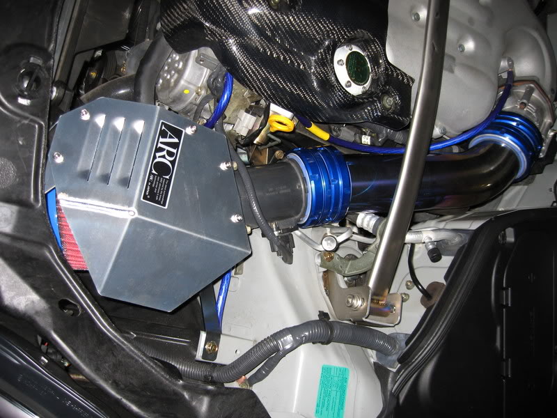

The tb spacer wouldn't fit my setup (amuse titan tube/arc intake/pi-thon locks)--The option was either to cut the titan tube or to lose the tb spacer )

Originally Posted by jonnylaw
Anyone else have problems fitting the tb spacer? Or am I the only one?
More specific?
Old Oct 16, 2007 | 10:38 PM
  #118
OCG35's Avatar
iTrader: (33)
Joined: Nov 2004
Posts: 17,181
Likes: 154
From: OC - So Cal
Sorry you're having problems jonnylaw... do you have a pic of your intake? If it is metal with the mounting bracket to the plenum welded (on the tube side of course) - it's probably at 90 degree to the intake tube correct? If so, there isn’t much wiggle room... There was another interested G owner with aftermarket metal intake and that was an issue (from looking at it) with his too... the only option I can think of is cut and re-weld the bracket farther up the intake or at an angle to allow downward/frontward (towards grill) clearance. I don’t think your air box should be a problem unless there is no flex on your intake tube… if there is no flex I’m afraid you’re sol. Pics would help.
Most that have installed have Z-Tubes (and a few OEM I think) - I have not heard of anyone having problems installing. There are several people still asking for these, so worse case scenario you can probably re-sell it.

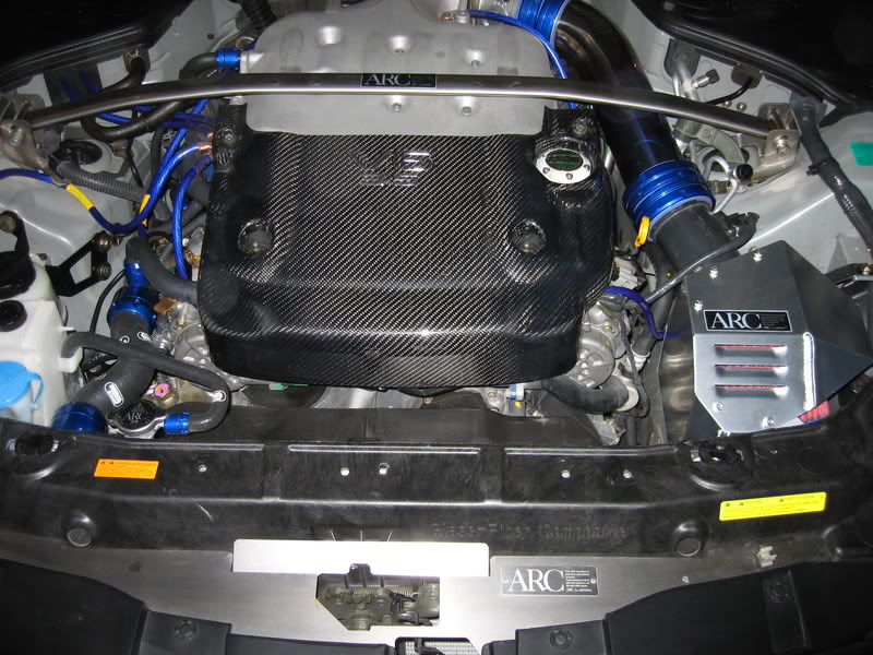

yes there is absolutely no flex in the intake tube its straight Titan and the tech told me that everything was just barely fitting before trying to install the tb. He said he could cut the titan tube and i was like no! but he worked on the car another day so it is possible that he may have made it fit. I will likely find out tomorrow and will update then. Thx for the supports guys!
Old Oct 17, 2007 | 01:49 AM
  #120
jonnylaw's Avatar
Joined: Jun 2005
Posts: 1,498
From: Meifumado
Here are some pics of the intake tube and my engine bay:
