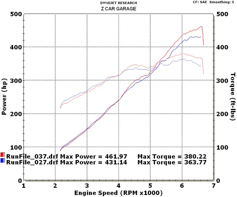

***Update 1/21/12
The third dyno sheet is my before and after Vortech install. The only other mod I made before the Vortech system was install an ARK Grip V2 Dual Exhaust which made 14whp/15wtq and before this was the spacer on sheet 2. These numbers are untune prior to the Vortech.
I also included a sheet that shows my gains at 100 octane.

I installed the MD 5/16 Copper Iso and Thermal plenum spacer this week and got it dyno'd today at zcargarge again. This mod made the car run lean so I need to reflash to gain the maximum output from the spacer. I did get decent gains at certain points in the rpm. But you can see it detonates at certain places in the higher rpm's. So far this is the only mod I have added. Best bang for the buck I still agree!
