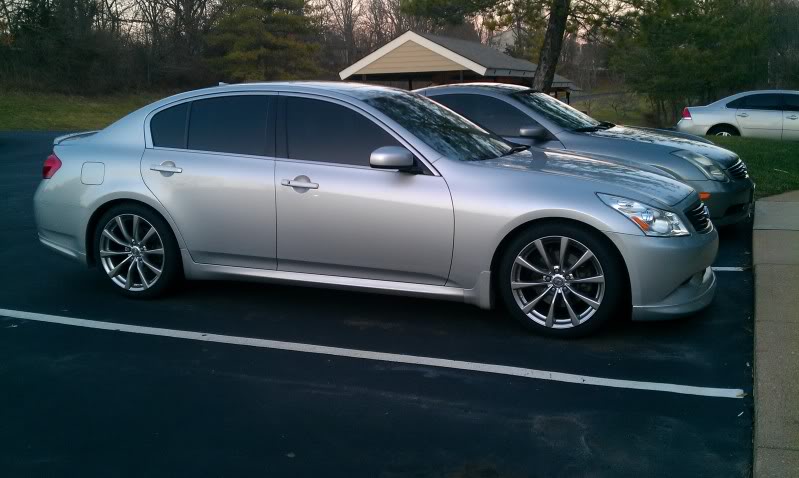

AWD....Swift Springs, G37S 19x8.5 +43 around, Continental DWS 245/40/19 tires

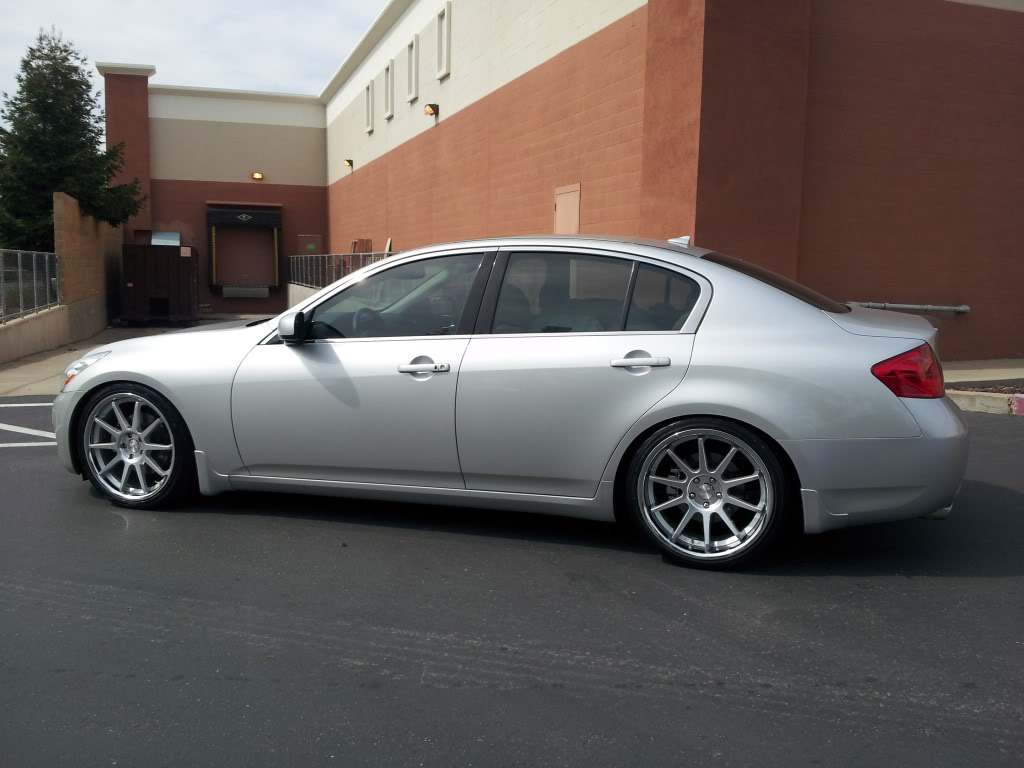

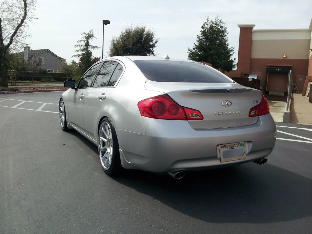

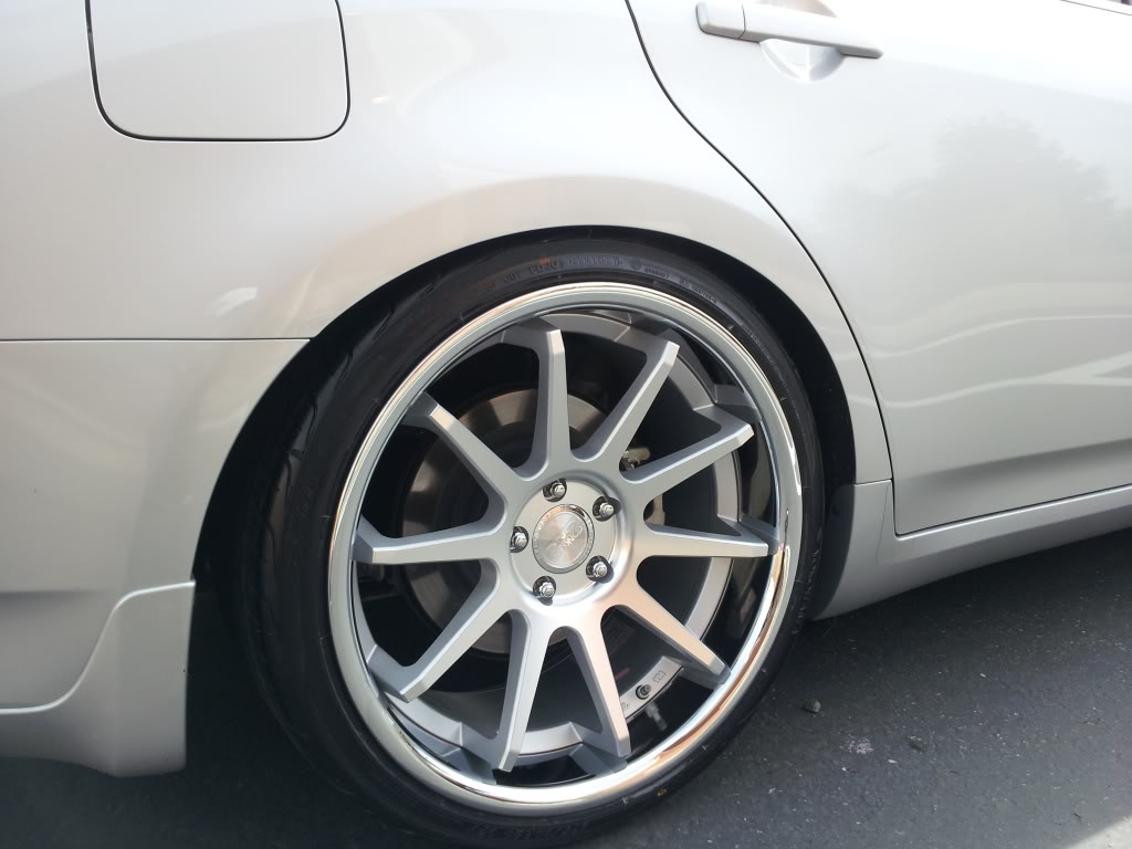

After buying the G35 in late 2007, I finally got bored of the stock look especially after years of seeing all the sick modded Gs here. And after month's of research and countless PM's to forum members, I settled on the following:
Coilovers: Tanabe Sustec Pro S-0C
Camber Kits: SPC Front and Rear
Tires: 245/35/20 f and 275/30/20 r
Wheels: Concept One CS10
-20x9 +36 f
-20x10.5 +45 r
Thanks to SoundMike for the countless PMs on offsets and widths. Also thanks to B2Autodesigns for the CO and Camber Kits. Finally thanks to Rusty at TNT Autobody and the rest of the TNT Autobody crew for helping me get the CO and Camber Kits installed. Anyone in Sac that needs install help go see these guys. I'll try to get some proper photo's together but for now some phone camera shots...
Old Apr 14, 2012 | 07:16 PM
  #104
blnewt's Avatar
Posts: 1,699
Likes: 137
From: New Mexico
-20x9 +36 f
-20x10.5 +45 r
Looking sharp, nice drop & wheels too
