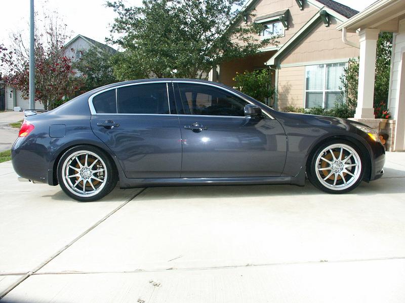

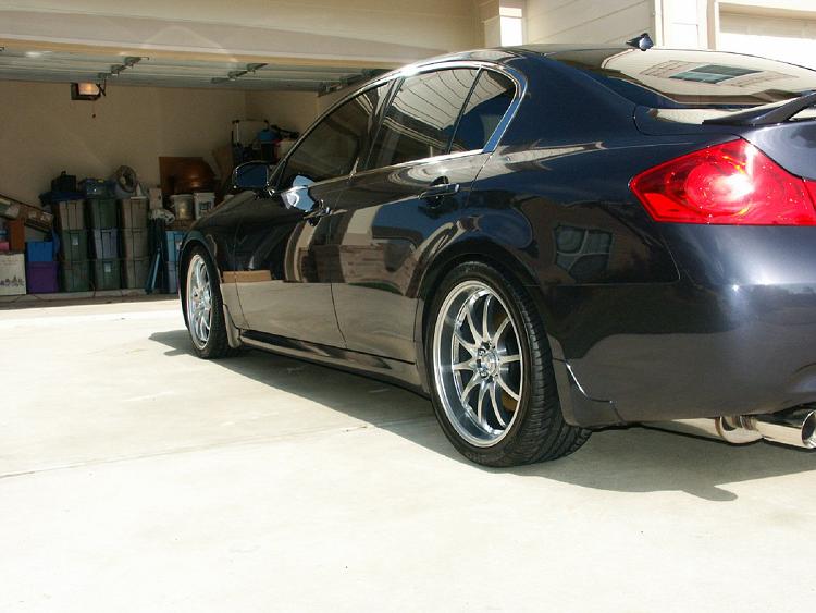

Here are two picks of the eibach springs on my car. They were done late last week, so they haven't settled yet, but gives you an idea.
I actually just PM'd Kalvinmaui, about buying his coilovers, so if you are interested in a set of used springs (less then 120 miles on them), I'll hook you up cheap .
