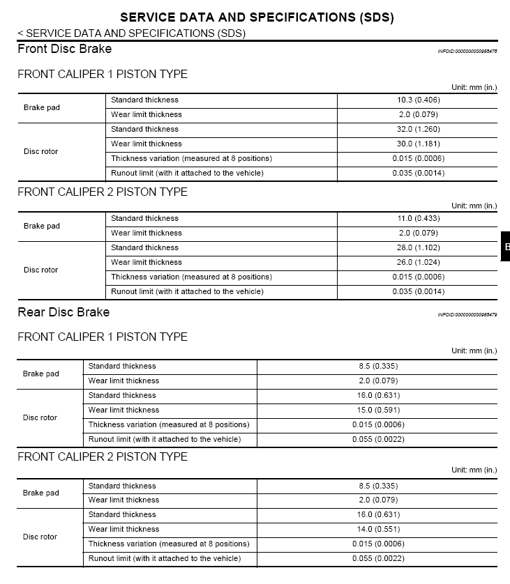

Here's the spec for the rotors mentioned earlier, by the way.
