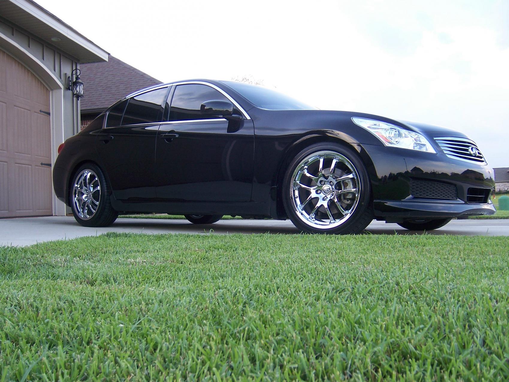

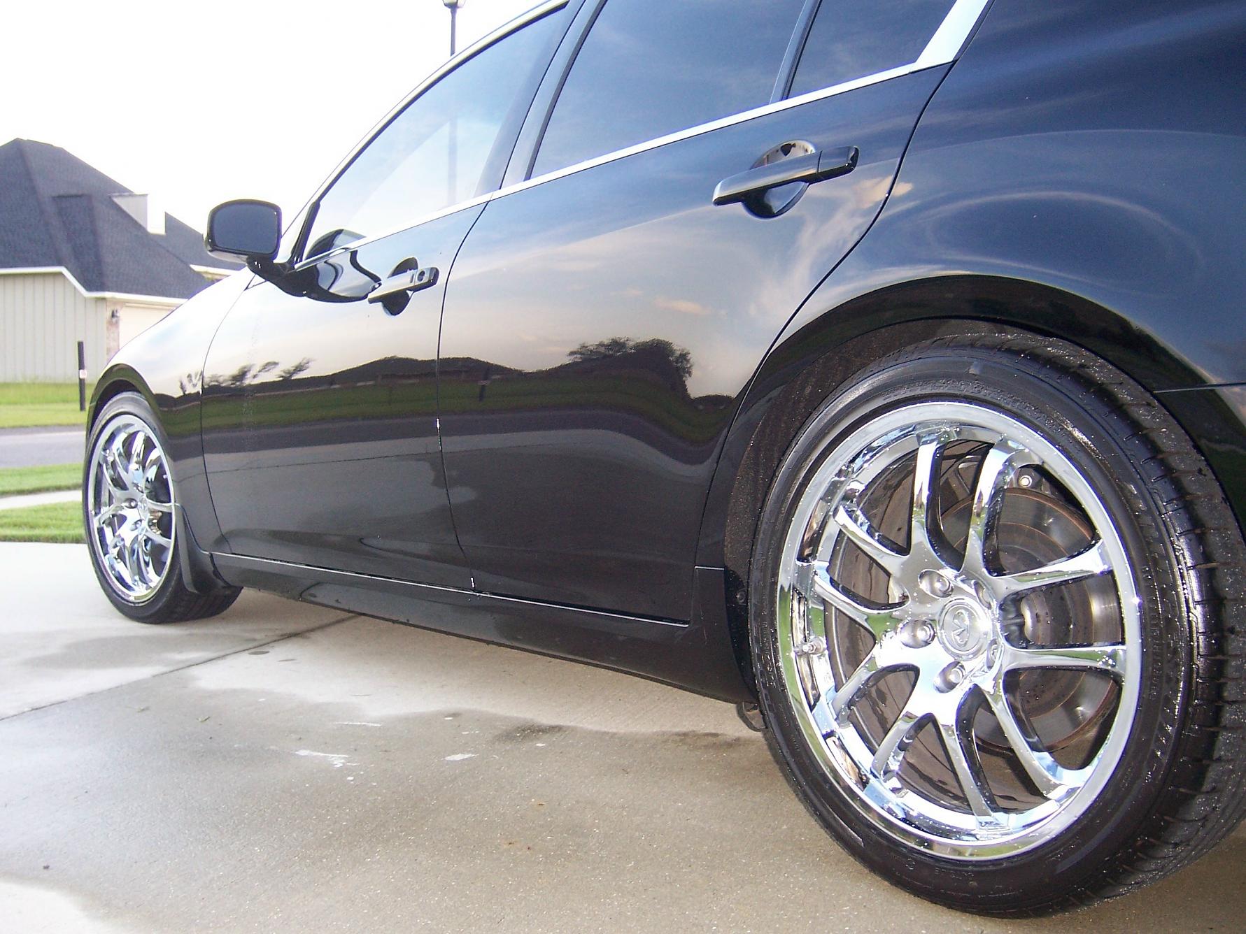

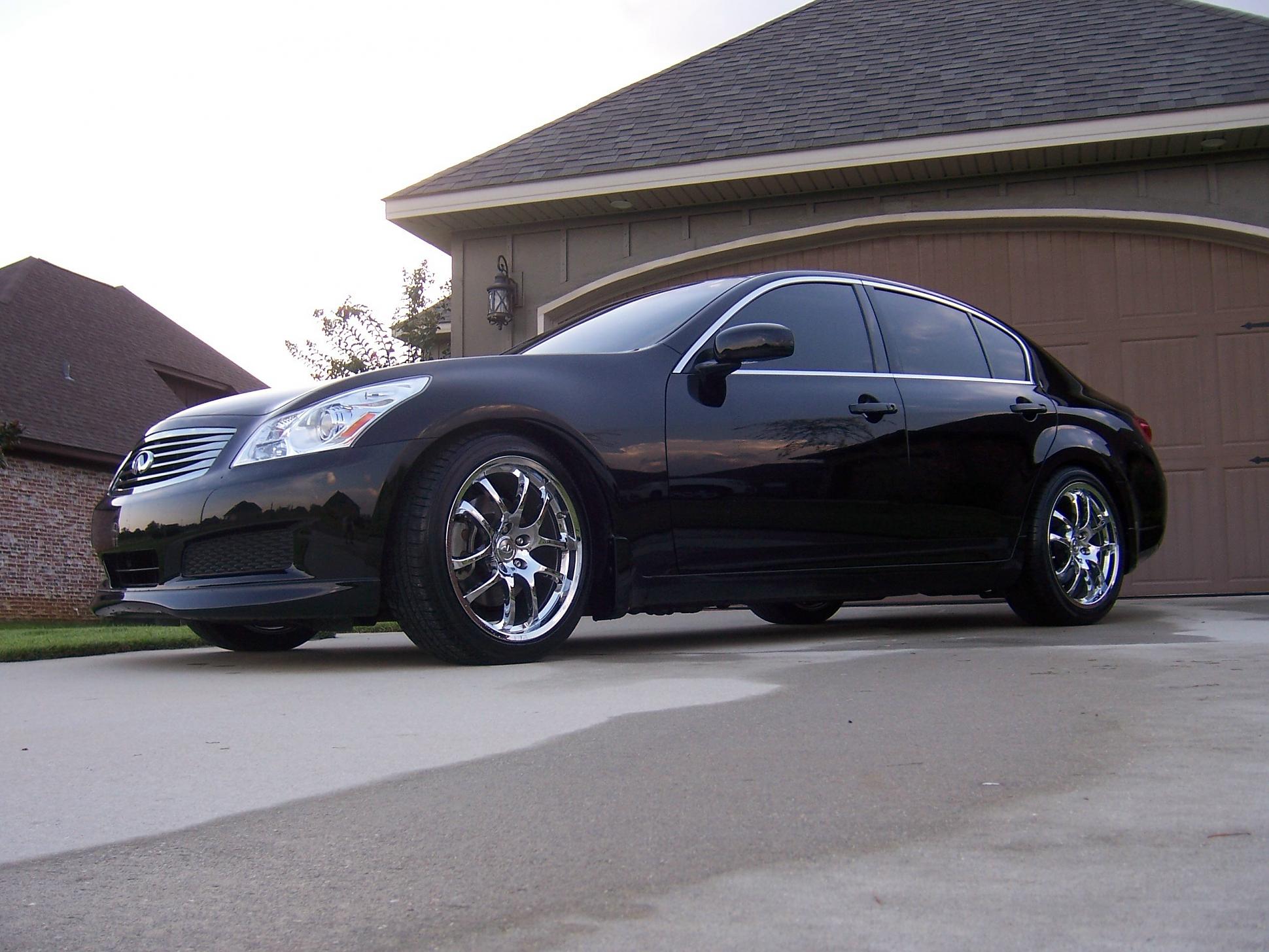

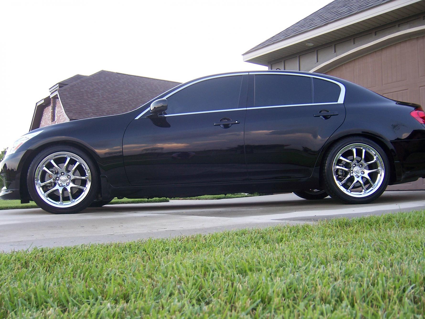

Well, for those of you following the "370Z Spring Experiment" thread, I've completed my install of 370Z springs in the front and shaved 5/8" off the rear spring mount. In my opinion the drop is perfect. For those of you looking for a mild drop with no loss of ride quality, this is the route to take. I'm 100% satisfied.

Thanks for the great comments everyone. I'm much happier with the wheel set-up now that I've dropped it a little. It's amazing how much difference a small drop can make. To see it in person, it's a whole new look, hard to see the true difference in pics.
Wes888: The wheels specs are: Rear 19X8-1/2 +30 Front 19X8 +33 (I think those #'s are right). Anyway, they are the coupe rims I'm sure you can find specs pretty easy. I'm using the factory spec tires 225/45 Front, 245/40 Back.
As for performance...the straight line ride feels identical to the factory ride. I'm sure there is a small difference but not enough to notice. I did notice that there's not quite as much body roll in the corners, probably just because the center of gravity is a little lower. The ride and stance is exactly what I would have expected Infiniti to deliver on a stock G35.
Yarrh: I picked up the springs for $200/pair because I have a friend who sells parts, but I called Nissan and they were about $248/pair.
