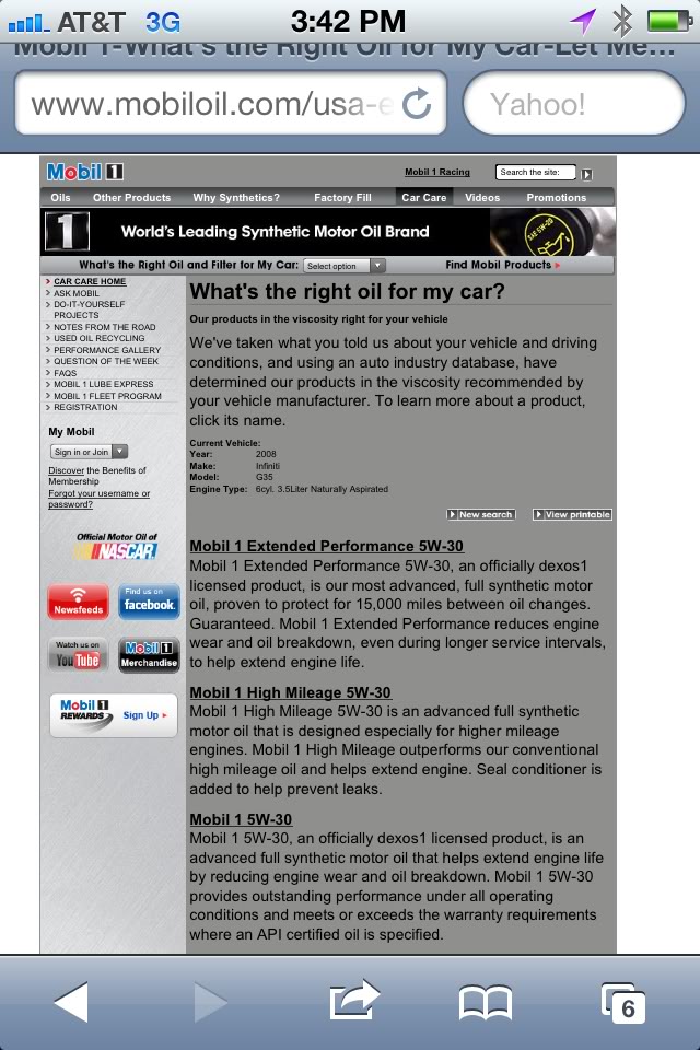

Quick question!! I am about to do an Oil Change on the G for the first time, usually the dealer would do it but I am gonna start doing them myself. I am gonna go synthetic but I am not sure exactly which one to get! What do you guys recommend? 08, 47xxx miles! And what kind of oil filter? Thanks in advance!!

I use 0w-30 mobil 1 and fram oil filter...

How about 5w-30 Mobil!? Remember the weather in Los Angeles is always great!
5W-30 is perfectly fine. Get a WIX filter #51365 (or a Napa Gold #1365 = same thing) and call it a day.
