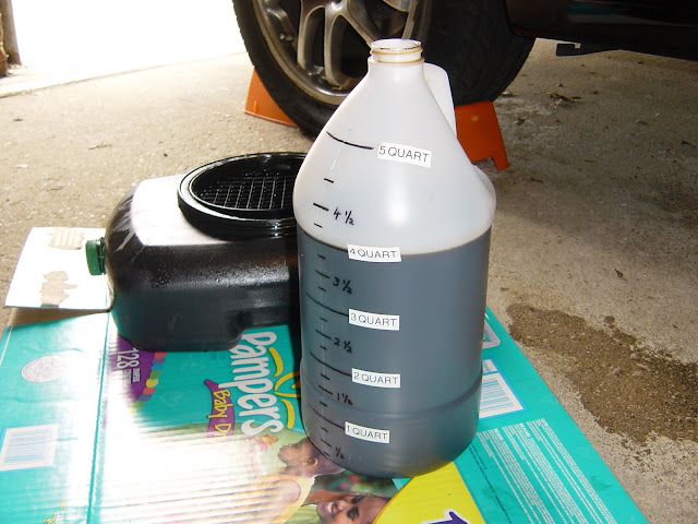

Step1: Put the car on jack stands or on a lift.
Step2: Loosen the drain plug and drain the tranny fluid.
Step3: Go in to your engine bay and top it off through the A/T fluid dipstick.
Be sure you fill with the exact amount of fluid that was drained. Use something like this because every car can vary 3qts-5qts.
You only need your basic socket set.
Takes less than 5 minutes to do.
