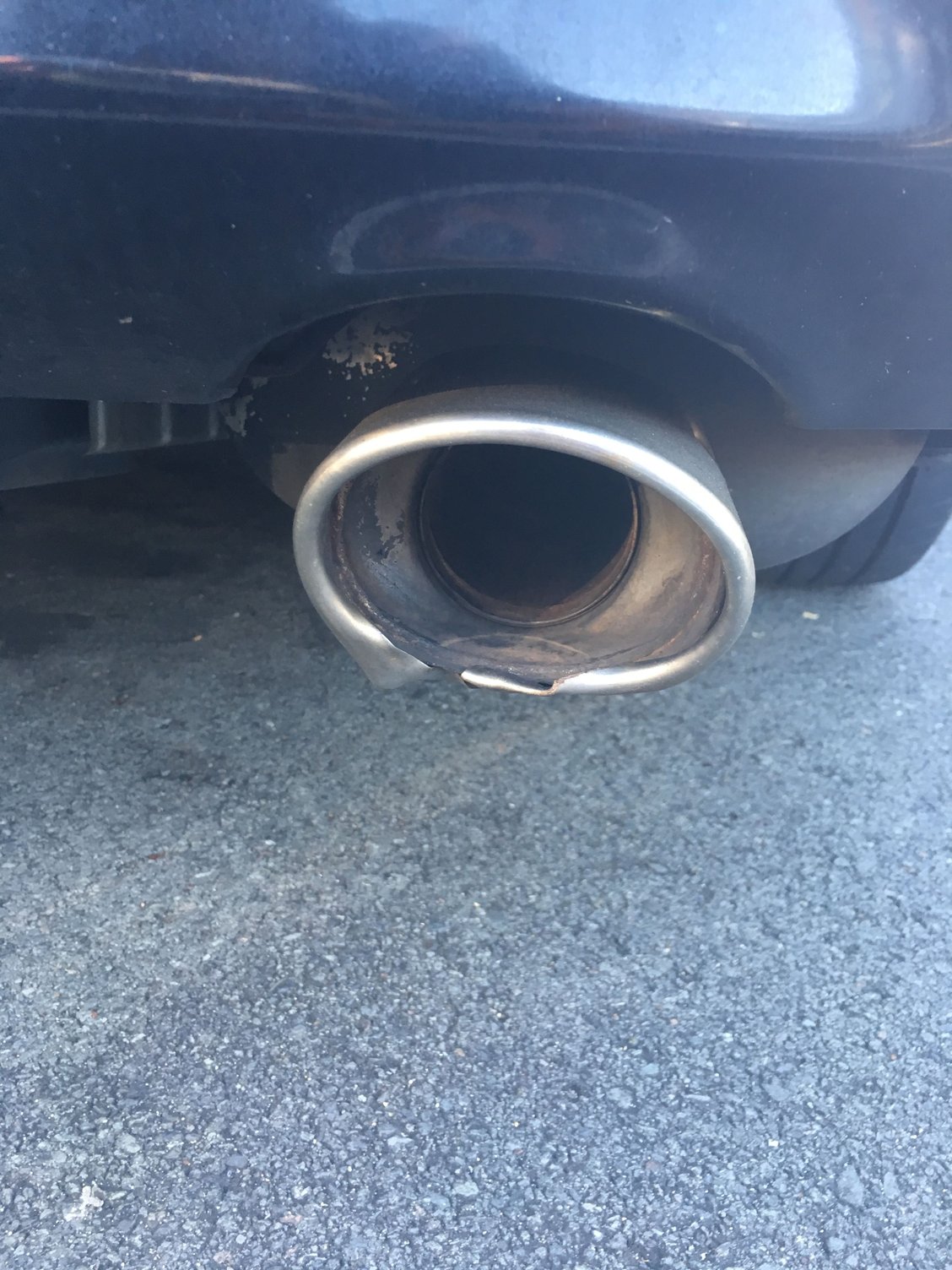

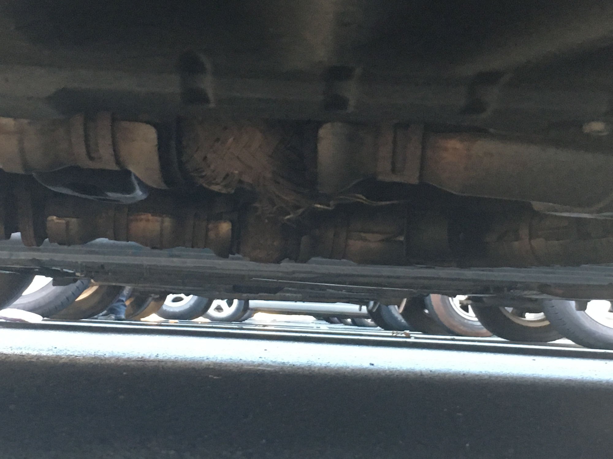

The mid section seems fine so I could forget about replacing that part of the exhaust but I do need a new Y-pipe since my stock ones are covered in rust and the section with the weaved metal is torn on one side. And I also want to get a new rear section since the exhaust tip on my right side is bent.
Here's a couple pictures
Bent tip
Rusty and torn metal weave
