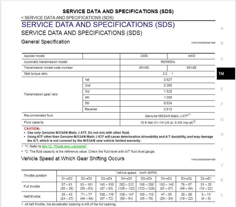

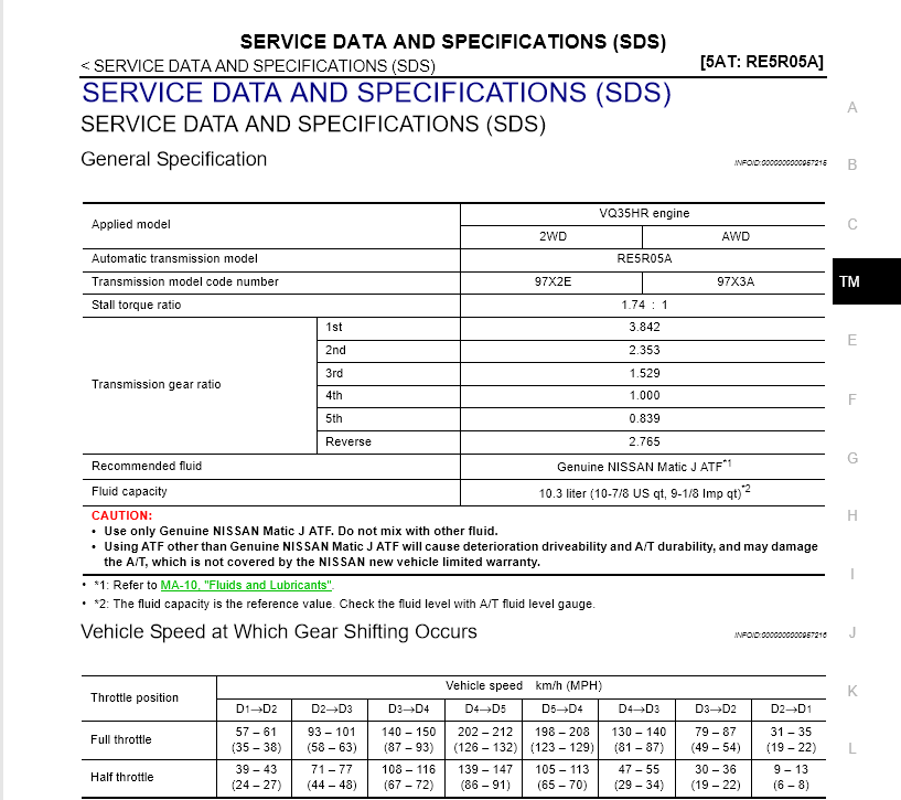

528 N-M in stock and transmission can handle this torque, but I'm not sure if it is possible. I even found transmission gear ratios in service manuals for G35 and QX56 AT and they look pretty same:
G35 gear ratio
QX56 gear ratio

It's hard to say whats going on without data logging the transmission while tuning pulls. The ecu has to be tuned just right or the trans will not shift correctly and burn things up. One question, do you have a shop tuning the car that has experience with the 5AT? To make a Titan / Armada / QX series transmission work you will need a shop to custom build it. The input shaft spacing and bell house swap will require cutting and machine work and driveshafts will need modifying too, in other words it's not a bolt up deal.

Unfortunately, I didn't find any service at this moment who will do this custom work. I know only that service who suggested this swap, but they are located far away from me. The serviceman told me that we will use the bell house from current transmission. But what most important, he said that QX56 has different planetary hardware and more 'thicker' friction disks. Is that true?

Sounds like the car just hasn't been tuned correctly. If it has already been acting like that and driven under boost for awhile it's probably toast and needs a rebuild. The QX56/Armada/Titan 4x4 transmission is a lot tougher. Has steel baskets and more area for clutch packs, billet steel 5 gear planetary instead of aluminum and 4 planetary and the internals weigh over 10lbs more. The big problem is that the input shaft / input drum is different than our car uses and cannot be swapped between. If you use the QX56 torque converter you will have to modify the VQ bell house to fit the large torque converter, modify trans mount and lengthen / shorten your driveshafts. That's just to make the front side of the transmission work, the output shaft will need to be changed to work with AWD instead of 4X4 transfer case too. It's a lot of work to get a 4x4 transmission to work in a awd but it is better.
