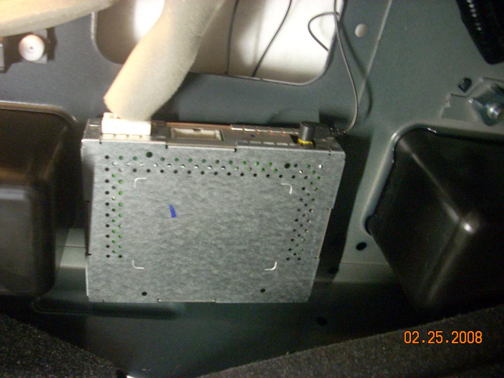

bfranks - mine is on the way as well. I've only had the G for a couple of days, so I'm a little hesitant about ripping it up already. Can you give a little more detail on how you actually mounted the receiver? I'm not going to be DRILLING or anything am I??

I used the double-sided tape that was supplied as part of the kit. I secured it to the right side between the two black plastic pieces (covers seat belt hardware). There was a natural gap there, and it allowed easy access to the back deck opening for the antenna run. No drilling required.
If you do not have Nav then it's slightly different.
Hope that helps.

Thanks! I guess if I had waited to post until I had actually received the box in the mail, I'd have seen the tape and had a little better idea. I have the Nav, so should be an identical install.
I've been a Sirius subscriber for 3 years, didn't want to lose NFL and Howard. This was very nearly a deal killer for me, but I really loved the G and thought I could learn to live with XM. Thanks to your help, I'll have it all now.
