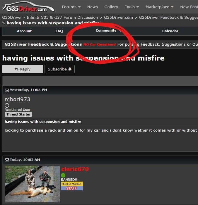

having issues with suspension and misfire
looking to purchase a rack and pinion for my car and i dont know wether it comes with or without evo. my car is a 2007 g35x but some reason i think some idiot decided to glue a S after the X.

Get the car up on jackstands, remove the lower engine bay shield, look at the rack. Does it have a solenoid with a couple wires hooked up to it right next to where the steering shaft attaches? If yes you have electronic variable steering. If it doesn't have a solenoid and no electrical wires going to it you don't have EVO

Also, moving this thread to the appropriate subforum. The one you posted in is reserved exclusively for feedback about the website itself, no car questions.
