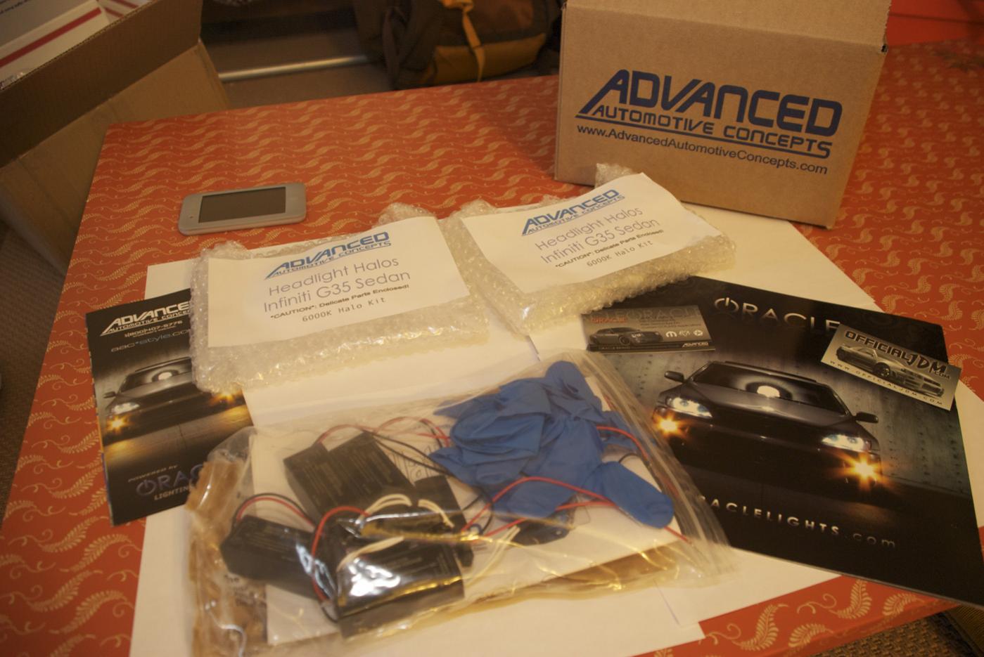

By the way this is the picture of Halo kit.
Enjoy it
Dame.. I don't know how to make picture big...
Sorry about that.
