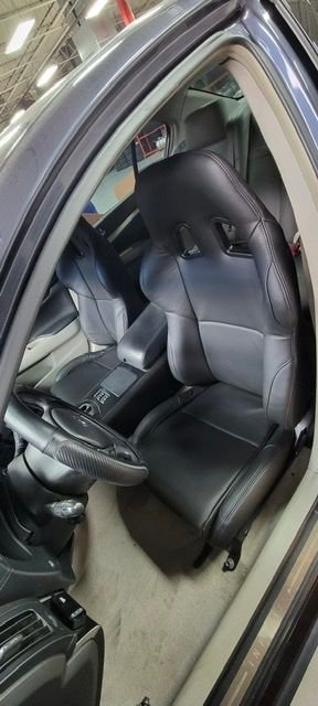

Since the stock seats are basically sofas with no lateral support, I wanted to upgrade to a true bucket and found that the A4 seat by Corbeau is a very popular choice. Given it’s relatively small dimensions, lots of Corvette C4-6 owners opt for them.
The seat fits up to a 36” waist. I have a 32” and find them very comfortable and supportive. Sliders need to be ordered separately which I wasn’t aware of until they were installed. Luckily, bolted to the closest setting forward, I’m able to drive without cramping or stretching. Height is perfect. Weight savings with these is substantial to say the least. I just weighed my stock seats….64 lbs each. The A4s are listed at 26. Factoring in the heating element (swapped into the Corbeaus) and mounting bracket, I’d say there’s at least a 65 lb total weight savings, equivalent to 10 gallons of gas. All in all, a good purchase.

Those are quite handsome! but looking at them they don't look that bolstered (on the bottom) really not any more than the stock, nonsport seats. So you can still make these work with stock heated seat parts? They do recline? any lumbar adjustability?

Yes, bottom seat bolstering isn't that much more than stock. That's actually a good thing for a street car because ingress/egress is very easy. Furthermore, high bolstering simply isn't needed in the twisties, at least for me. For the track, perhaps but not for public roads. I have Recaro Pole Positions in my Cayman and those things are a chore getting in and out of due partly to high bolsters. But once situated, they can't be beat. Now the backrest bolstering on the Corbeaus is where it counts. It's more than adequate but forgiving enough for the larger driver. Again, they are a really good street only driven seat.
The heaters can be removed from stock seats and transferred to these. They work perfectly fine. The A4s also have a lumbar option where a squeezy hand pump (think blood pressure) is provided.
They do recline but as I stated in my writeup, you'll need to order sliders if you want the fore/aft adjustability. I'm 5'9" and am ok with the seating position because there's no clutch. If there was, I'd need sliders for sure.
