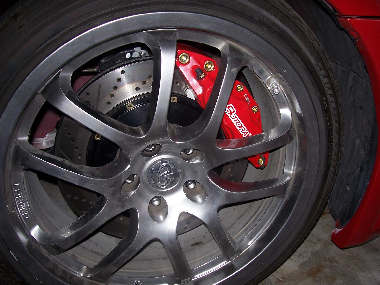

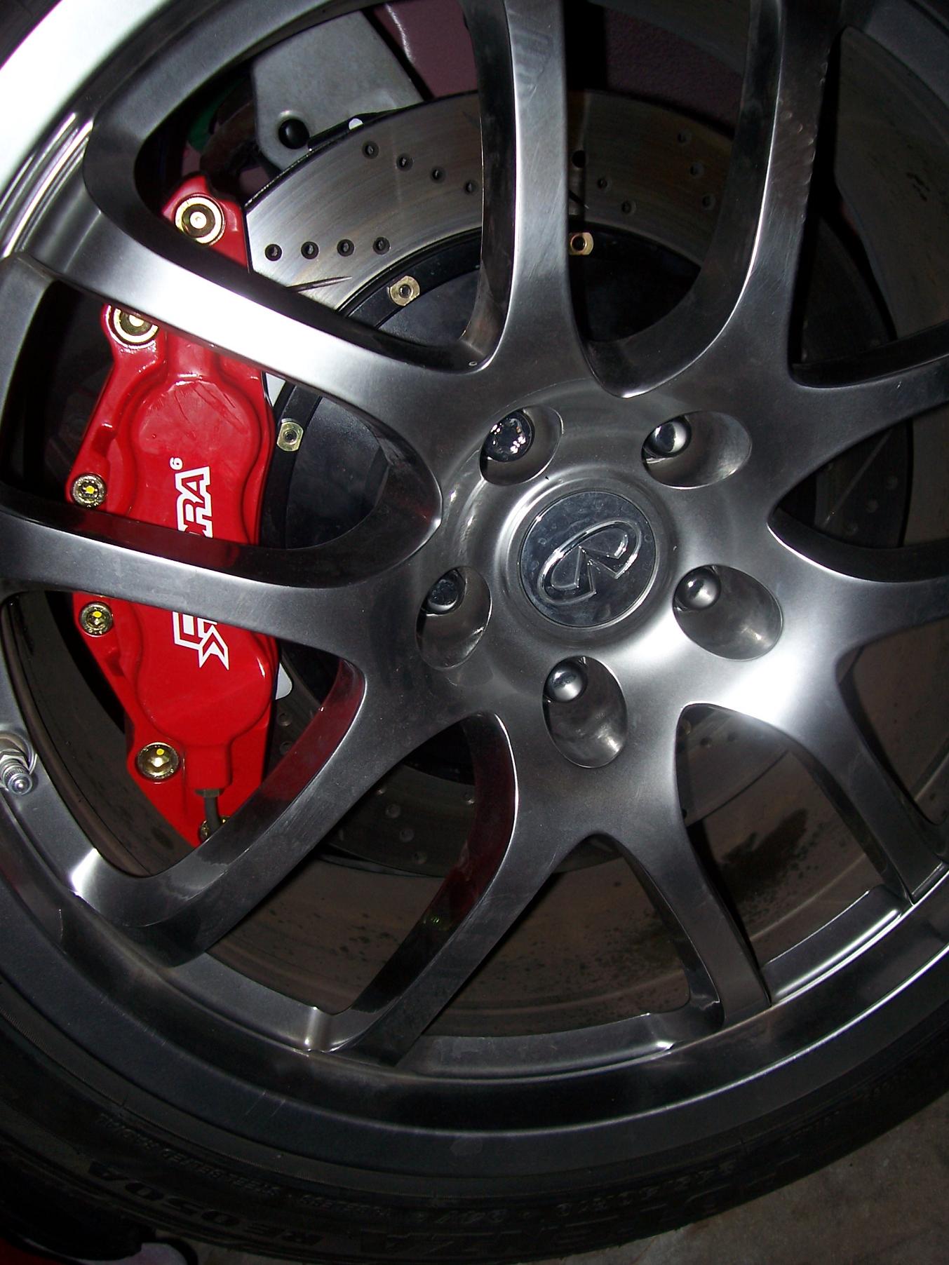

I finally put on my brakes and wheels in front dont fit.can I get a spacer for that or I am ****.Iforge said they could send two wheels with back space for 1400.Then I have two wheels thats not going to be used.Any body know what spacer to use.I need about 1.5 to 2inch space to clear the brake.

I run a 5/8 or 5/16 i cant remeber which.. spacer from Pep Boys to clear my brembo's with my SSR's. They have various sizes at Pep Boys and run bout 15 bucks. I was able to use my stock wheel studs with the 5/8 spacer, barely... If using a spacer I would recommend longer wheel studs.
Now if you need 2 inches I would recommend u get the proper offset wheels, or u will be rubbin your fenders.

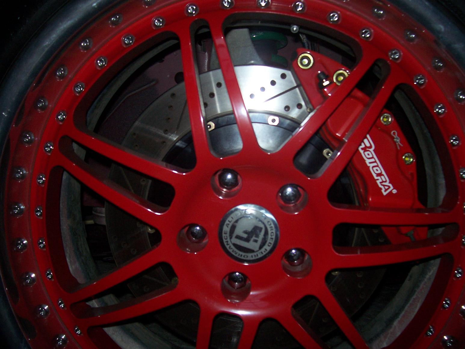

I ordered spacers from ichibausa 5mm and 15mm.The spacers are good but they did not clear the brakes.The 5 to small the 15 to big so primier performance in pembroke pines FL custom made some for me 150 for the pair.They fit right in the hub perfect .So any body have the same prob as me check them out.
