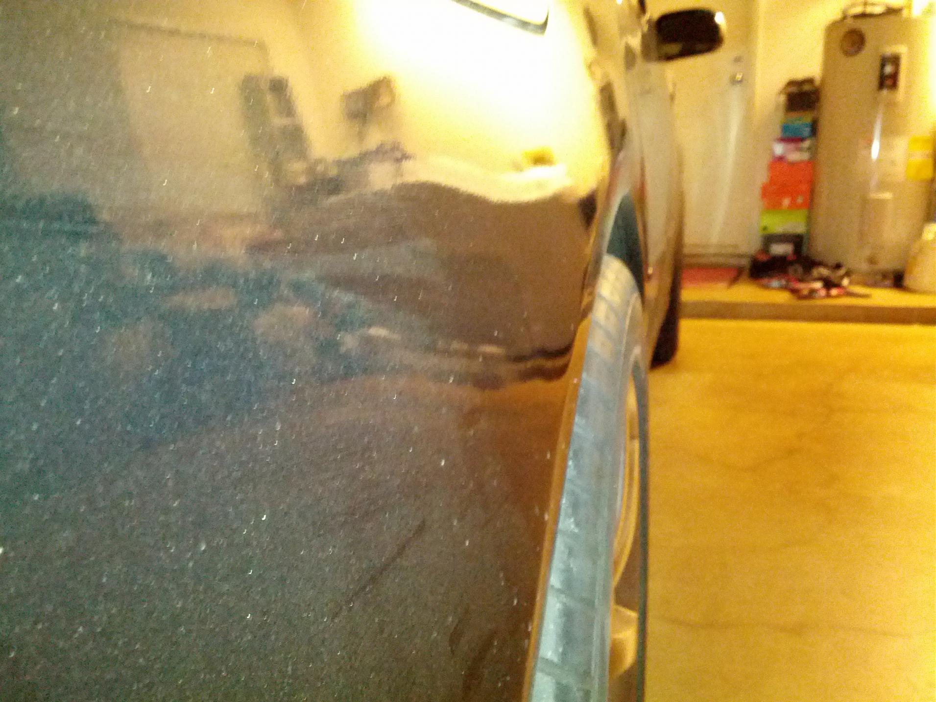

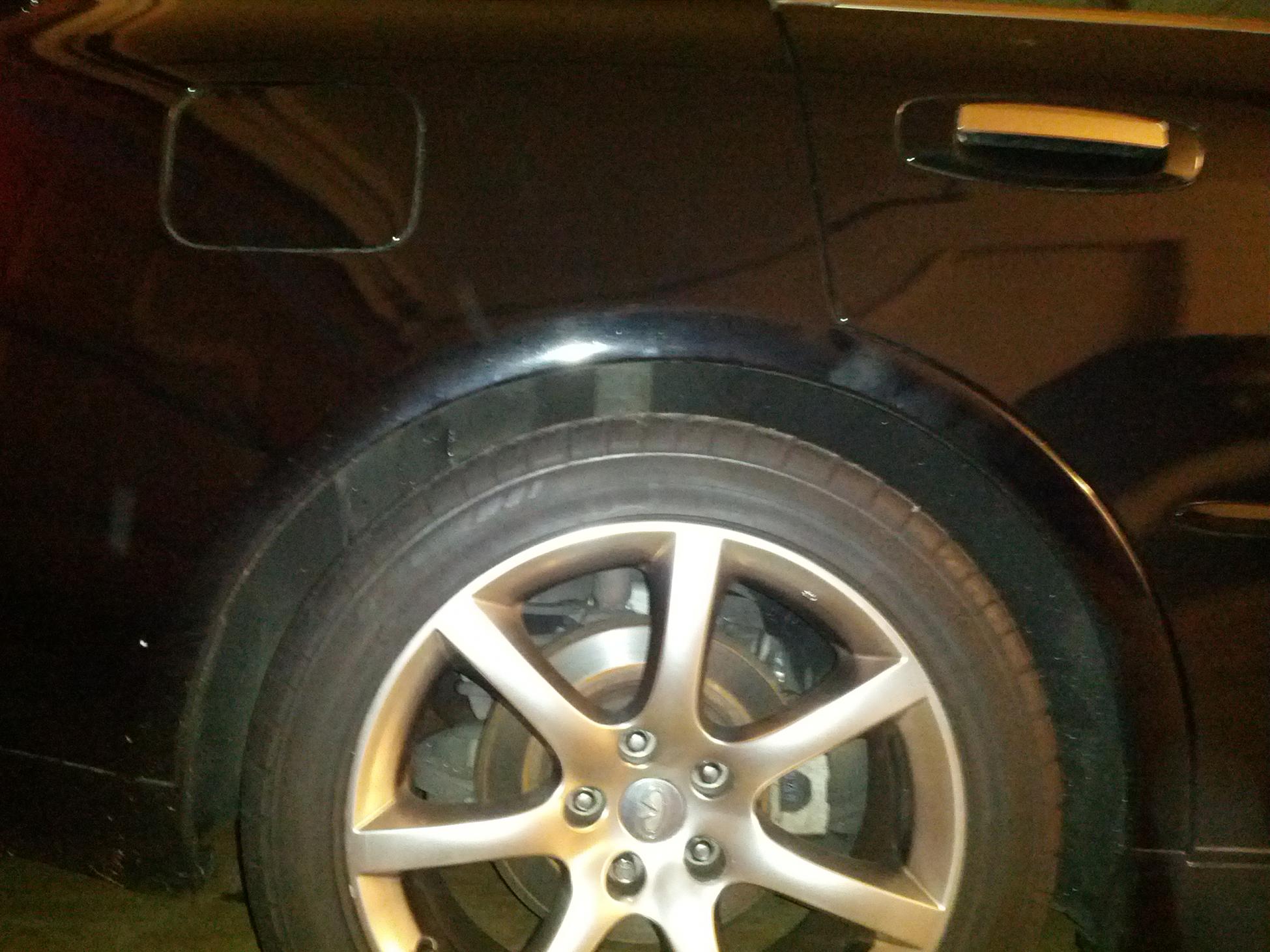

4DGS, thanks again for your advice regarding rolling fenders using revised Z or Z/G suspension on 245/45/18 on the rears. These are some pics with stock suspension, your advice looks on point. I'd be a little skeptical dropping the rears as is. The stance is mean though (In my opinion, not a fan of a lot of poke/camber). Yes my car is dirty it's been raining here = \

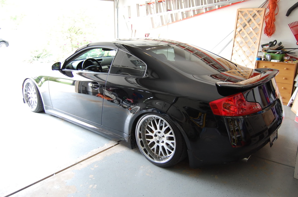

OK! now that I've decided on my wheels... What kind of camber should i run? currently running -1.2 in the front and -2.0 in the rear...
19x9.5+17
19x10.5+22
planning to get ACHILLES or one of the true/large running sized tire.
Looks good man!
19x9.5+17
19x10.5+22
DPEs?
You're going to need roughly -4 out back if you don't plan to pull. But a very mild pull could get you into -3 degrees.
Front, just dump it and hope for the camber to be even, then just add spacers accordingly.

^ yea DPE Aristos... yea I'm already dumped! -1.2 up front and probably going to set it at -2. the rears are already -2.. hmm... maybe ill consider a slight pull to get it at -3... THANKS ONCE AGAiN!!!
