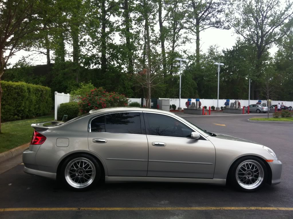

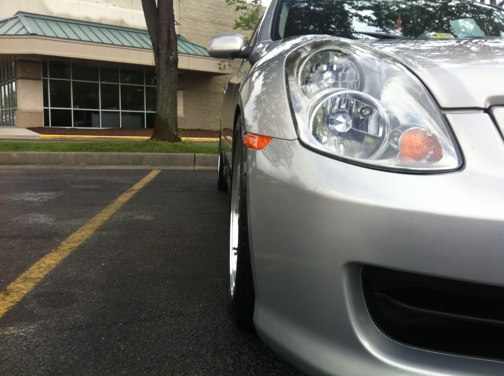

Posts: 8
From: Port Coquitlam, BC Canada
Ok thank you very much for clearing that up for me. I appreciate the advice
Old Jul 23, 2012 | 06:23 PM
  #3943
MPG35fiend's Avatar
Posts: 2,709
Likes: 302
From: Virginia Beach, VA
Originally Posted by 4DGS
Yea -4 is the norm for unpulled fenders.
Already dumped and only pulled -2 and -1? Doesn't seem very low.
LOL. thats because i have FRONT&REAR SPC camber kits..
the lowest i can go with feeling safe... use to be 0.8" lower before i got my front camber kit..

^^thats really not "dumped", its definately lowered but if you would be running -4 degress of camber and not lower than you are in that picture it will look weird...
Old Jul 23, 2012 | 06:27 PM
  #3945
MPG35fiend's Avatar
Posts: 2,709
Likes: 302
oh yea before i got my front lip i never scraped my front bumper its always just the bottom of my G.. i have like literally 2.5" clearance under my G.
