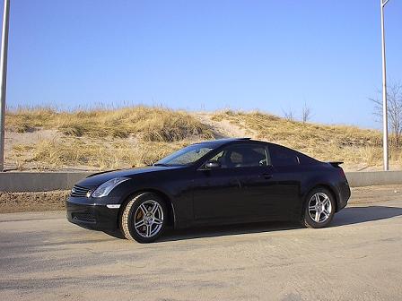

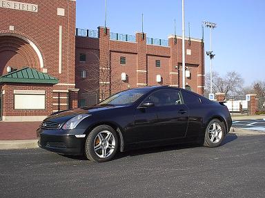

Here's my 03 6MT on 17" snow pack back in the day. No spacers needed.
Attached Thumbnails 17inch clear brembos?-wheel-1.jpg   17inch clear brembos?-wheel-2.jpg

wow, looks kinda funny with snow tires and small rims eh?
thanks for the input again,

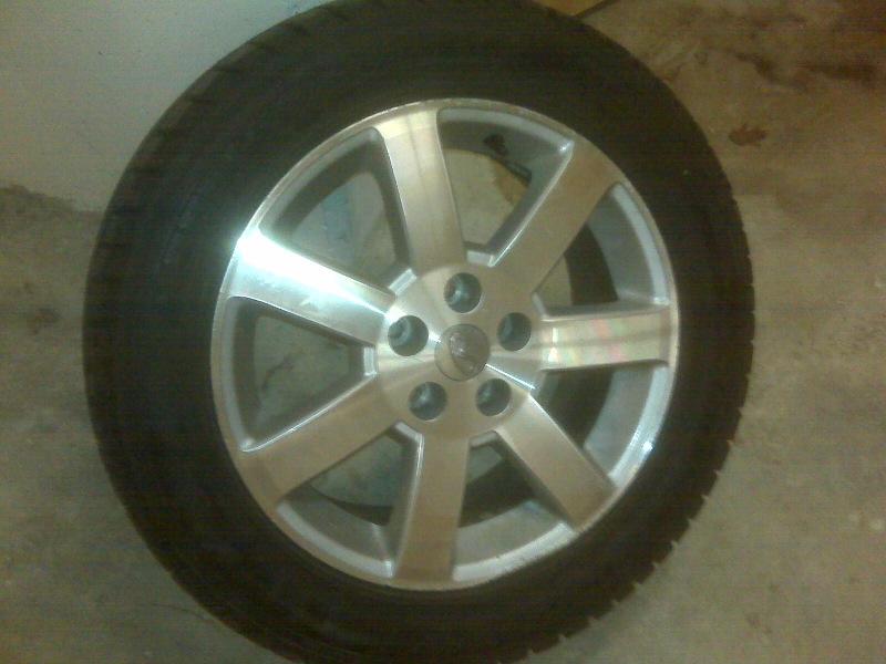

just to clearify any 17inch rim would fit, these ones im looking at are off 2005 g35 dont know about yours. dont know if it would make any difference.
i attached the pics

Only 1-2mm of clearance is actually needed. 3mm is the smallest spacer you can find though, and can be used with OEM studs/lugs. With 5mm spacers, new longer studs are recommend. Your wheels don't look like the OEM coupe wheels though so I don't know what the clearance is like on those
