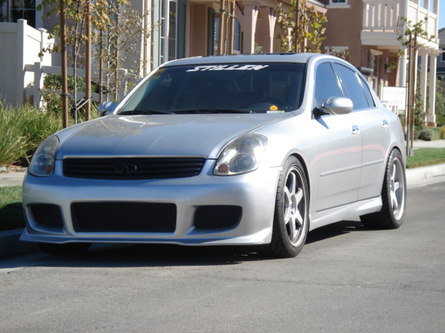

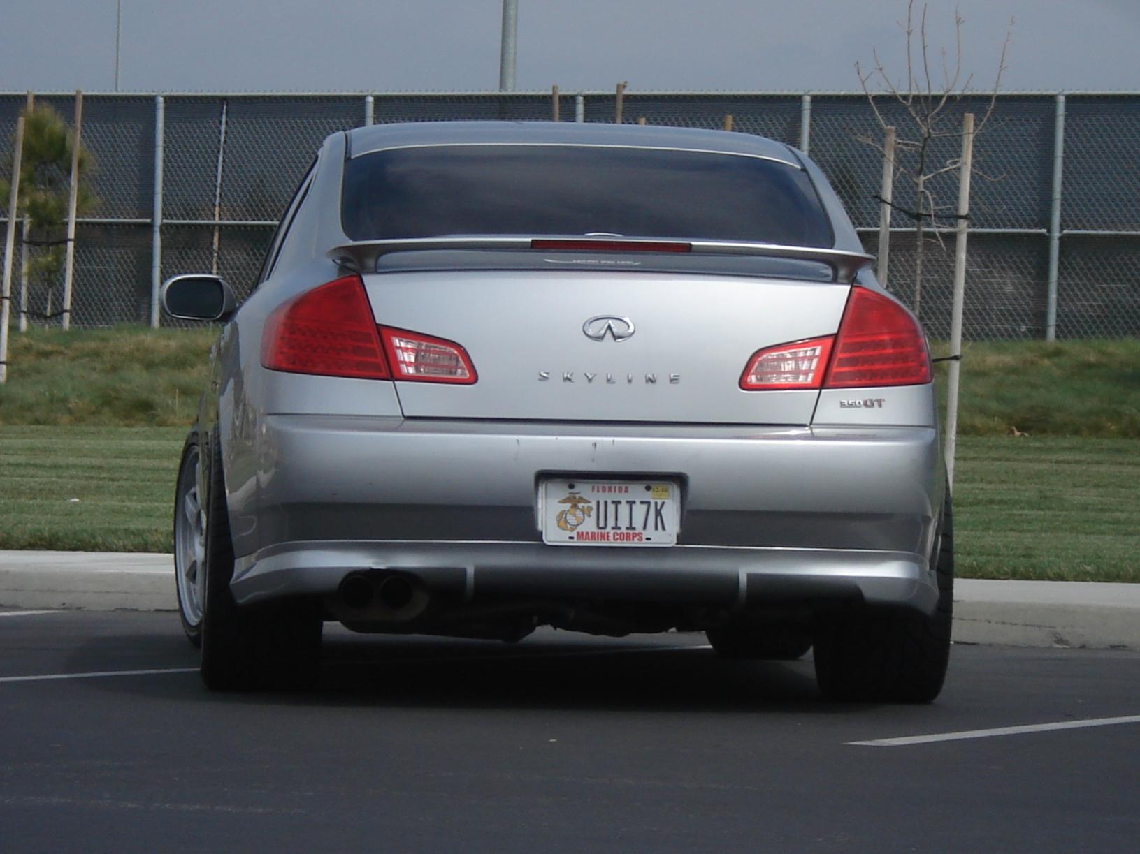

i have a 285 on my 9.5 wheel. it does rub, but i'm not running that much neg camber, it's close to stock for me. fenders are rolled and i do rub. couple of shots.
Attached Thumbnails Im trying to get a flush set up...help!-dsc01638.jpg   Im trying to get a flush set up...help!-dsc01695.jpg
