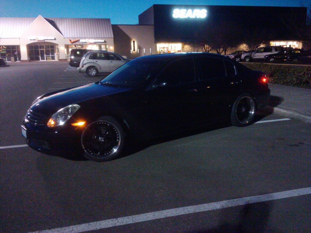

19x8 25mm with 235/35/19 in the front and
19x9.5 40mm offset with 255/35/19 rear. I love how the wheels fit (rear flush and front is almost flush)....rear rubs a little with rear passenger(s). I need to roll the rear fenders. This pic is before the 15mm front spacer.

If the wheel looks weird with 35 front and 40 rear offset, can I fix this problem with spacers?
4D05G35> do u have an awd sedan? What U lowered?

You can move the wheels out with spacers if they are tucked in too far.
