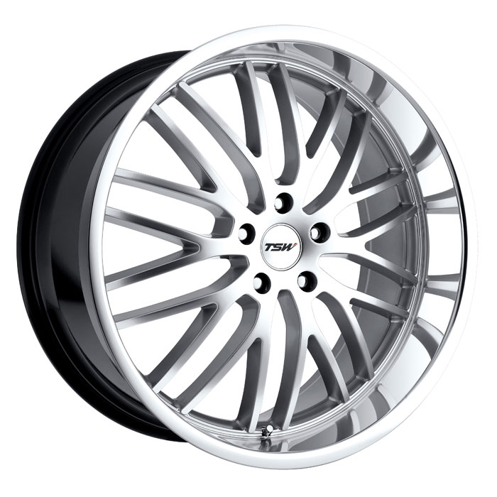

Looking to get these rims for my G35 Sedan...What you guys think....yes, yes i already know its aggressive for a sedan....
TSW Snetterton
19x8 fronts on 245/35/19's
20x10 rears on 295/35/20's

What are the offsets of those rear wheels. I only know of one Sedan (G Sedan) that is running tire sizes that wide and his fenders are pulled. Why run 19s up front and 20s out back?

+20 or +40 is offered on the 19's for the fronts
+25 or +40 on the 20" rears

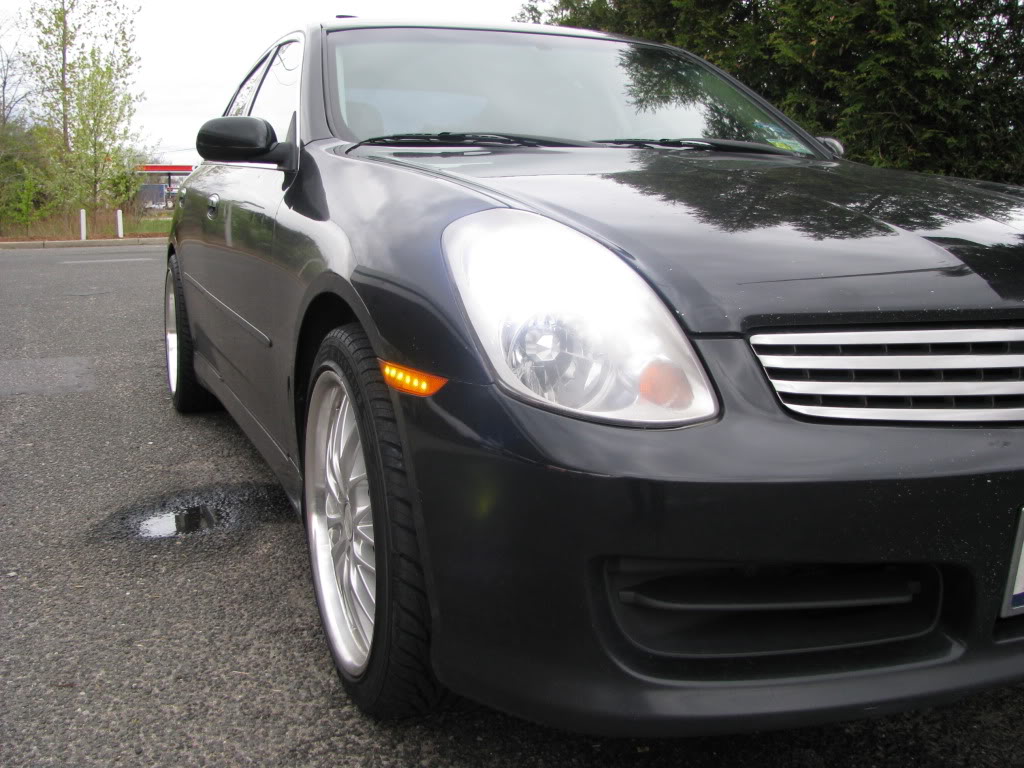

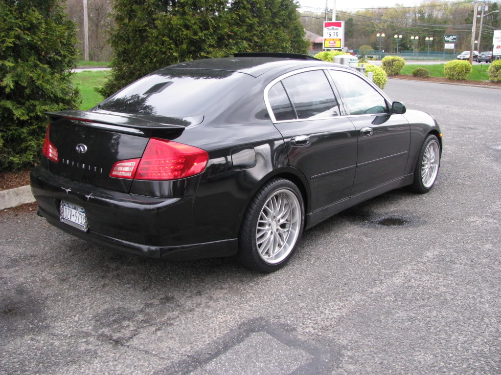

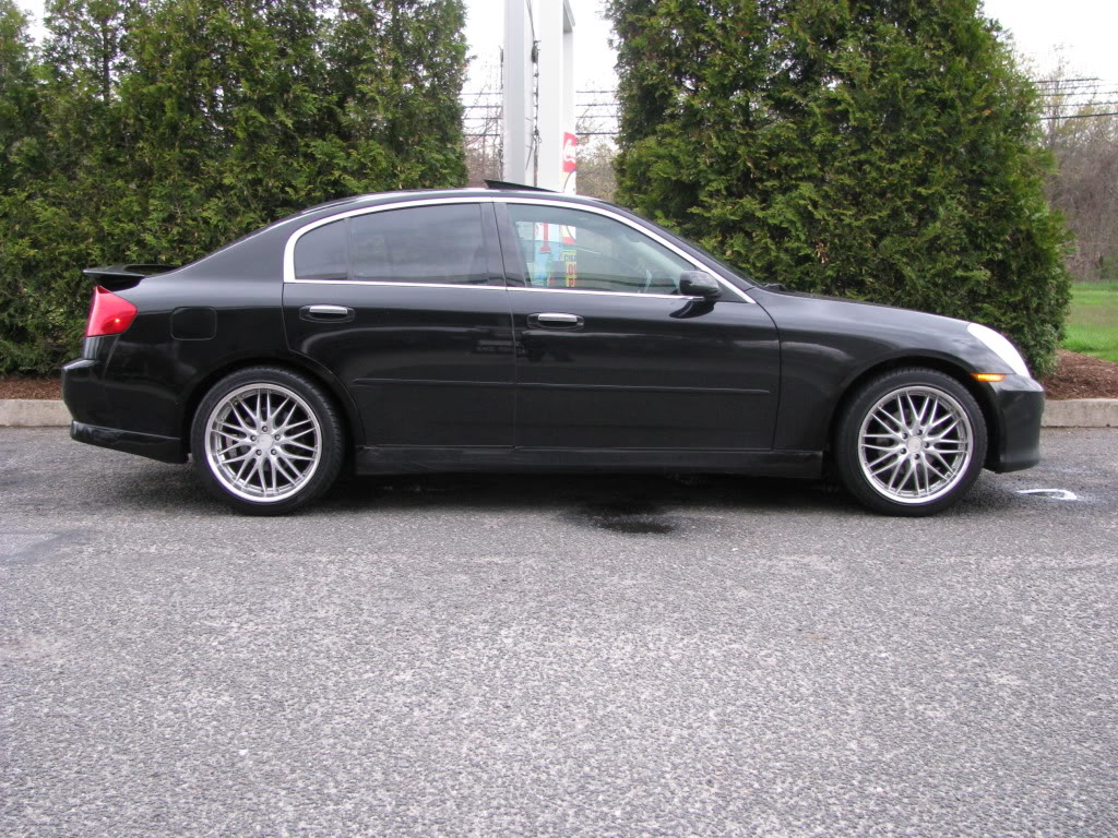

This is my G with similar 19" wheels. No drop yet. Just stock sport suspension. I'm running 245/40 F and 275/35 R...35 offset all around.... You can see the gaps. About two fingers in the back and 3-4 in front. Just adjusted the camber in the rear to about -1.28 (gotta confirm that once I find the sheet).
Looking to get some coupe springs to get rid of the gaps.

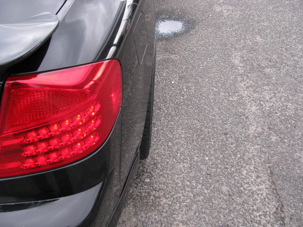

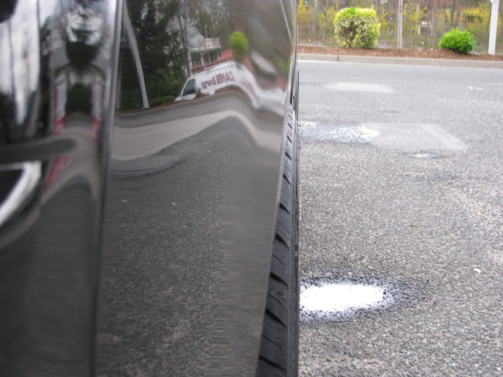

Only ones I had left in the camera...This is with the stock camber specs...I will take some better ones later.
