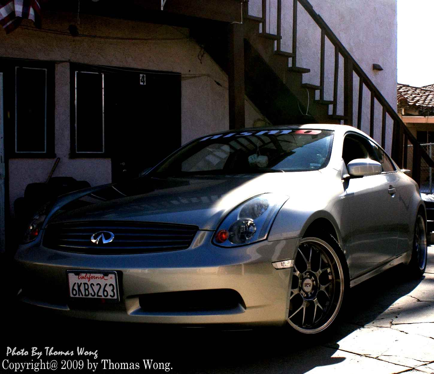

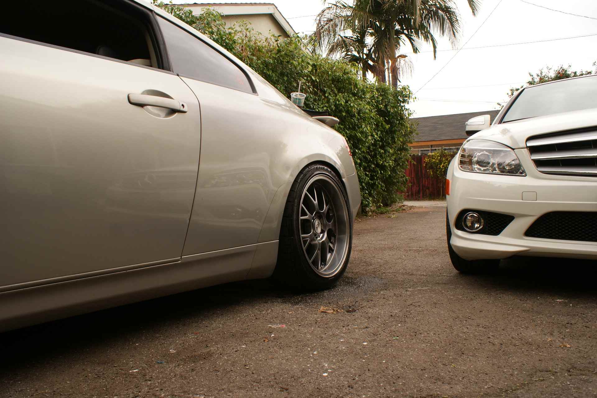

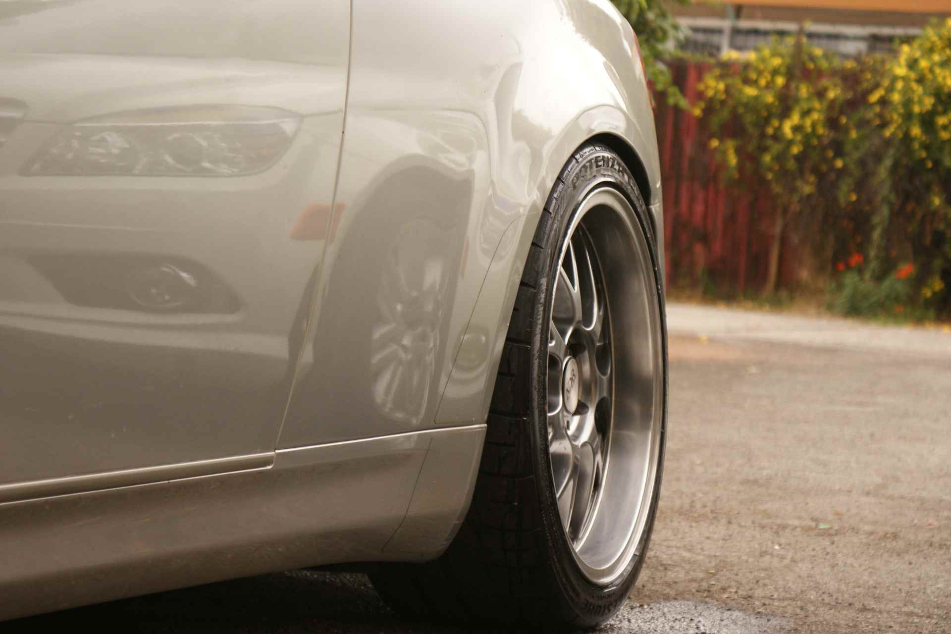

I got a 275 35 19 tires with 1' spacer and 1.5' dropped. would it hit the fender?
anyways does the rim look good on G35?
Attached Thumbnails would it hit?-front-bark.jpg   would it hit?-kk.jpg   would it hit?-ojlmk.jpg

that width is pretty standard for most 10.5 width wheels. However we need more info on the wheel, what offsets and width does the wheel have?
If those are axis pentas, then no they shouldnt rub.

i believe the rear is 35 offset and 11 width

Looks like ADRs, I don't think they're 11" wide, you measured the tire right?
275/35 is 11.xx" wide, hence why you think that.
It's probably a 10" You could do a 25 but I would suggest a roll as you're lowered.
