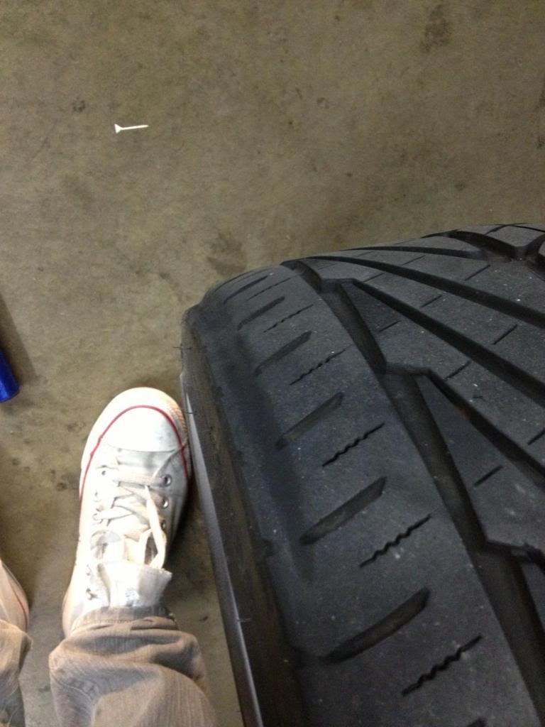

There is a vibration on the steering wheel starts from 80mph, Borrowed some jacks and found this:
Left Front Tire Gouge 1:

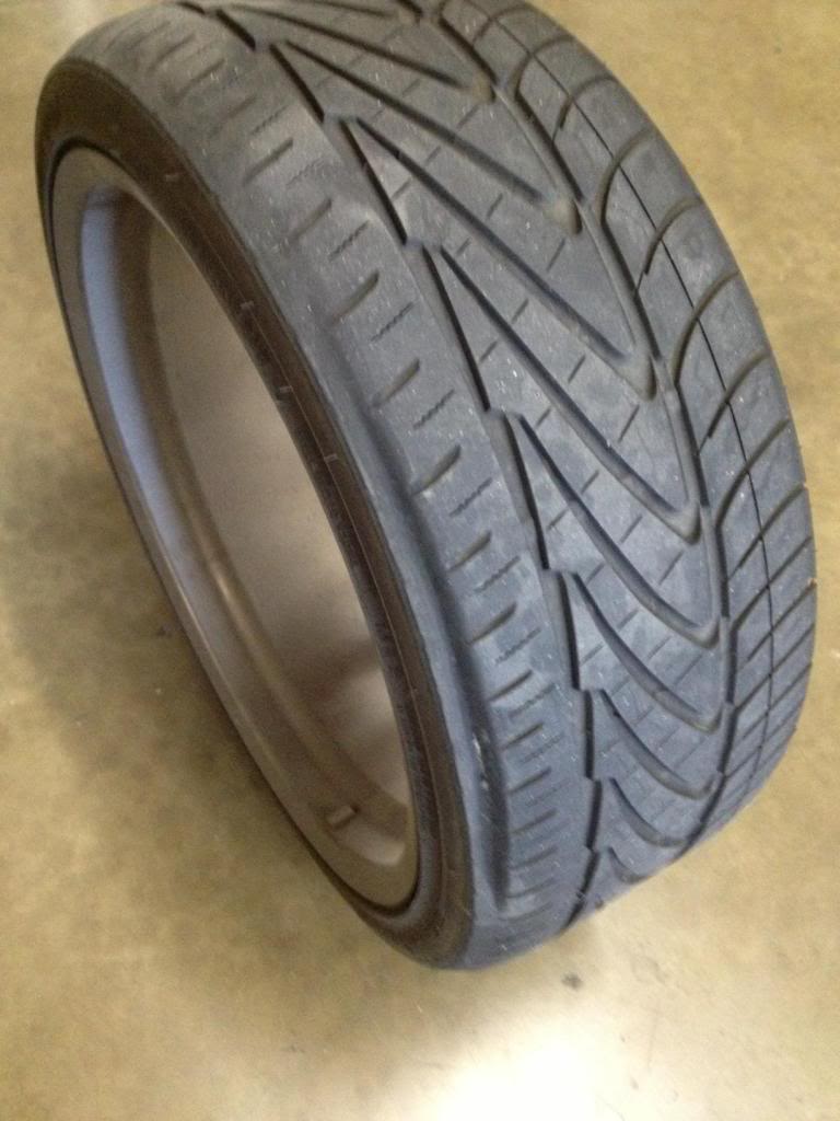

Left Front Tire Gouge 1 at different angle:

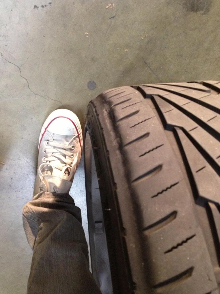

Left Front Tire Gouge 2: (Gouge 1 and 2 are almost diagonal from each other)

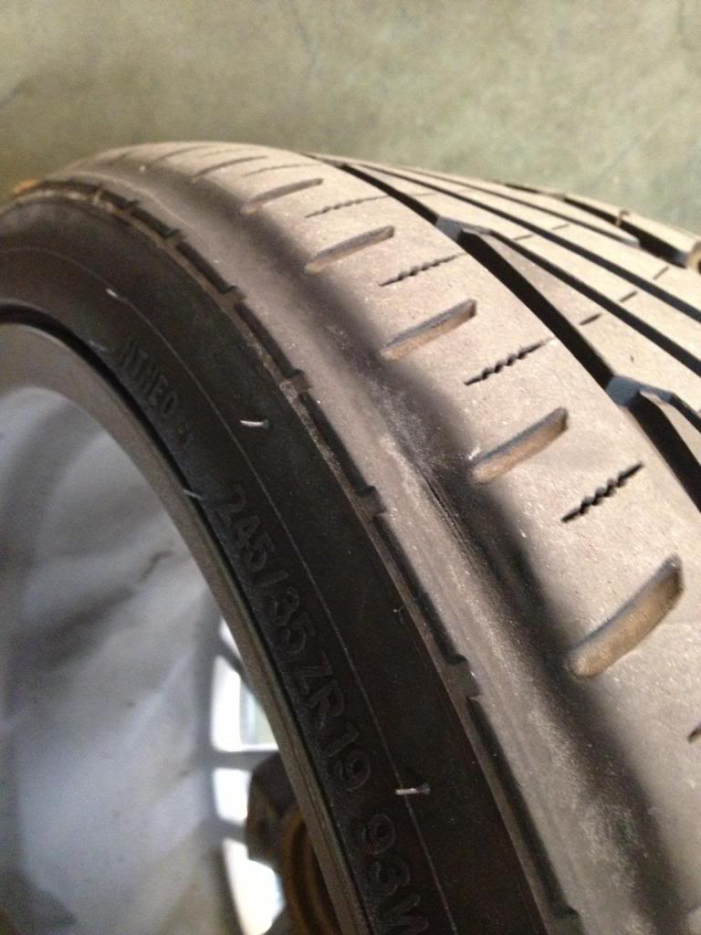

Right Front Tire Gouge 1: (Right Front only has one gouge)

I could be completely wrong but it looks like a belt is separating under the rubber. I'm 51 and have never seen a tire that looks like that, I'd take it to a shop for a professional opinion.

Nitto NeoGen tires? I'd have them inspected as Blue Dream suggests, those look defective to me. Not sure what kind of warranty Nitto offers, but I'd look into it.
If that was normal camber wear, or bad toe specs, they would be worn all the way around.

As a general rule of thumb: if there is a vibration, then something is wrong. I don't care what brand or make those tires are, they are ZR rated which means they should be able to handle 80 mph without any issues at all.
That's definitely a defect and not any kind of tire wear, you should check with wherever you got the tires from or even the manufacturer to see if you can get them replaced under warranty.

They should be replaced the belt slipped

Those are failed tires. Worn suspension would behave like a mis-alignment. I other words the tires would be trashed symmetrically around the inside. Those don't look like the tires were rubbing on any suspension parts either.
Quick search turned up Nitto's tire warranty: http://www.nittotire.com/Content/pdf...20Warranty.pdf
You have 60 months, and free replacement for the first 25% of tread wear. Anything past that can be prorated, you just need to find an authorized Nitto dealer.

That's real close to where the tread slab would be molded into the sidewall. Lots of stress in that area. I would replace it.
