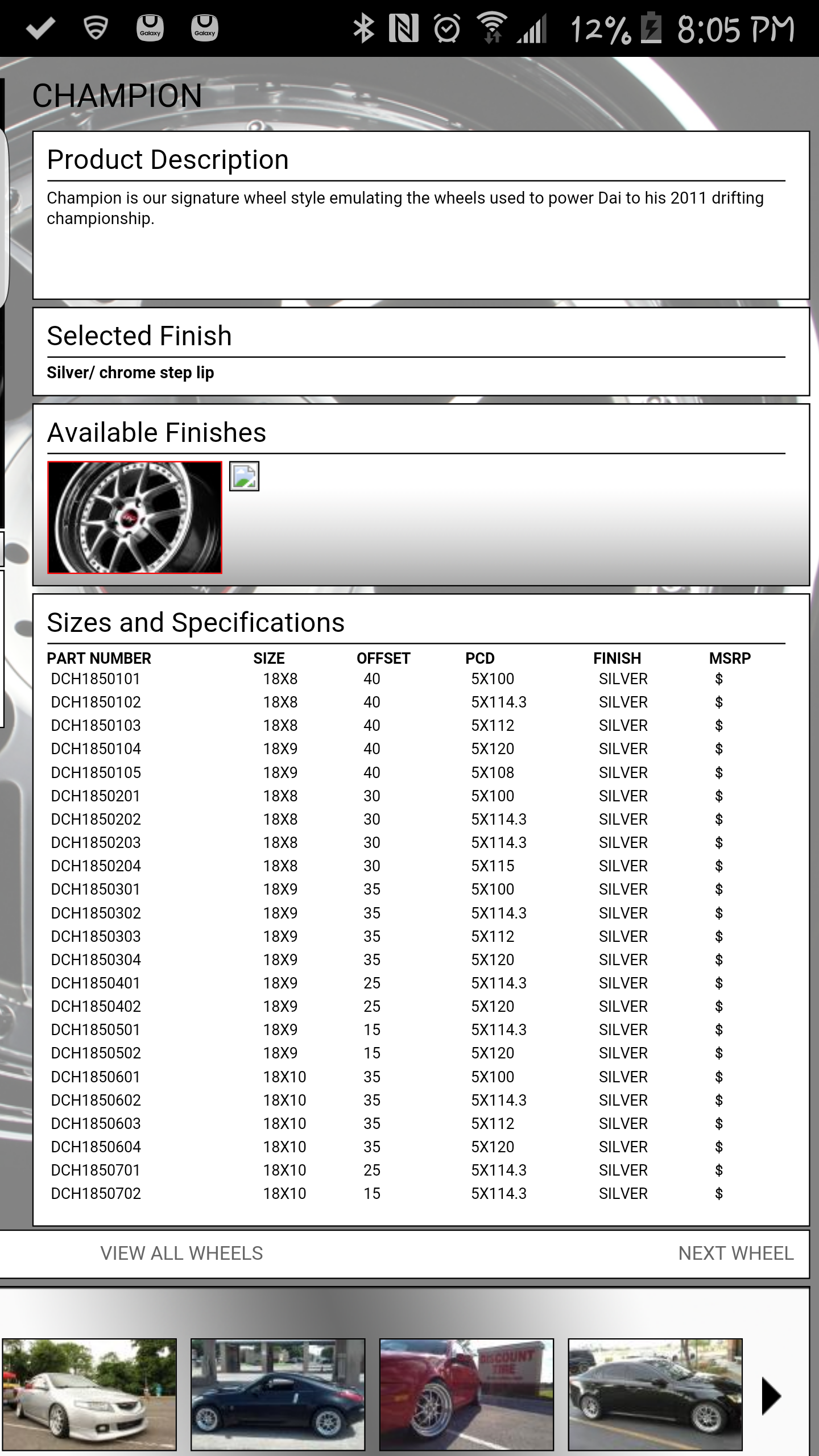

So I'm looking for wheels for my sedan and looking at getting Yoshihara design Champion wheels in the rear i want to get 18X10 but I'm not sure what offset to get I'm thinking +25 I want the wheel flush and not too much camber and i dont want to add spacers. could someone please help thanks

Originally Posted by portugueseG35
Yea it's called I googled didn't find the answer so I asked but thanks for the help
Go to my initial response and click the 6mt link, scroll to post 10 and read.
Or I'll quote it: "18x9.5 +20 will stick out past the fenders by about 10mm on your '05 sedan. My G coupe 18x8 +30's are pretty flush with the fenders."
So if the 9.5 + 20 will stick out 10mm, then the 10 + 25 will stick out ~2mm more.

Ok so I might have to go +35 and if need be I will have to get a spacer thanks Connisah
If the offset is too high then they will hit the struts. Look for a similar setup and base the wheels you are going to buy off of their specs that will be known to fit.
I'm pretty sure +35 will clear the strut fine I've read about people putting +40 on the sedan and clear the strut
