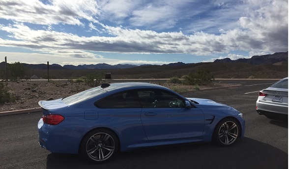

We left Las Vegas early morning hitting moderate traffic but eventually met more open roads outside the city leading toward Hoover Dam. The A/S 3+ responded great in/out of traffic and they really felt at home on the twisty roads leading up to our first driver change near the dam. At regular highway speeds the A/S 3+ was very quiet and rode great, even in the M4 with 19's. After swapping cars, we made our way through the foothills of Red Rock Canyon. The tire drove excellent and begged for more driving through the canyon. We ran into some high winds and rain which didnt affect the tire's performance or ability to hug the curvy roads. We spent a good four or so hours of public road time over the three different cars before heading to the track.

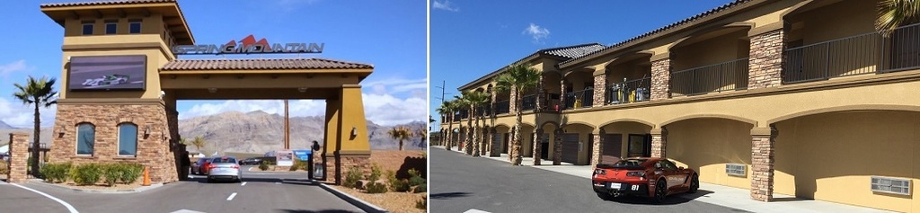

Our next stop was Spring Mountain Motorsports Ranch in Pahrump, Nevada to see how the tire performs when pushed to the max. This is a world class facility with over six miles of track, an 8,000 square foot clubhouse, pool, and even condos. They are also the official high performance driving school of Corvette and offer a two day Radical SR3 racing school. Three exercises were set up for us, a dry/wet auto-x course, dry braking demo, and lead follow on their track. Michelin put the new A/S 3+ up against Continental's Extreme Contact DWS06 and Pirelli P-Zero All Season Plus during testing.
