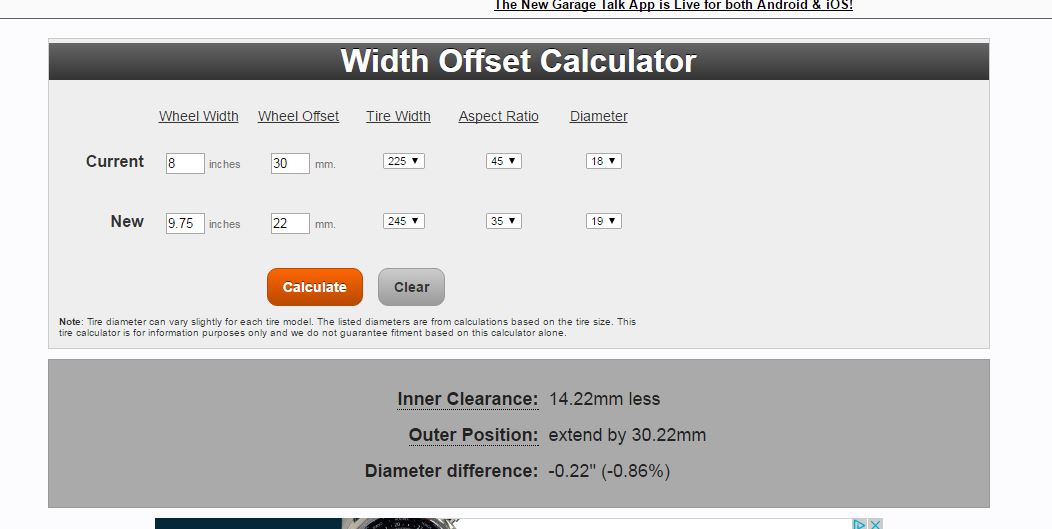

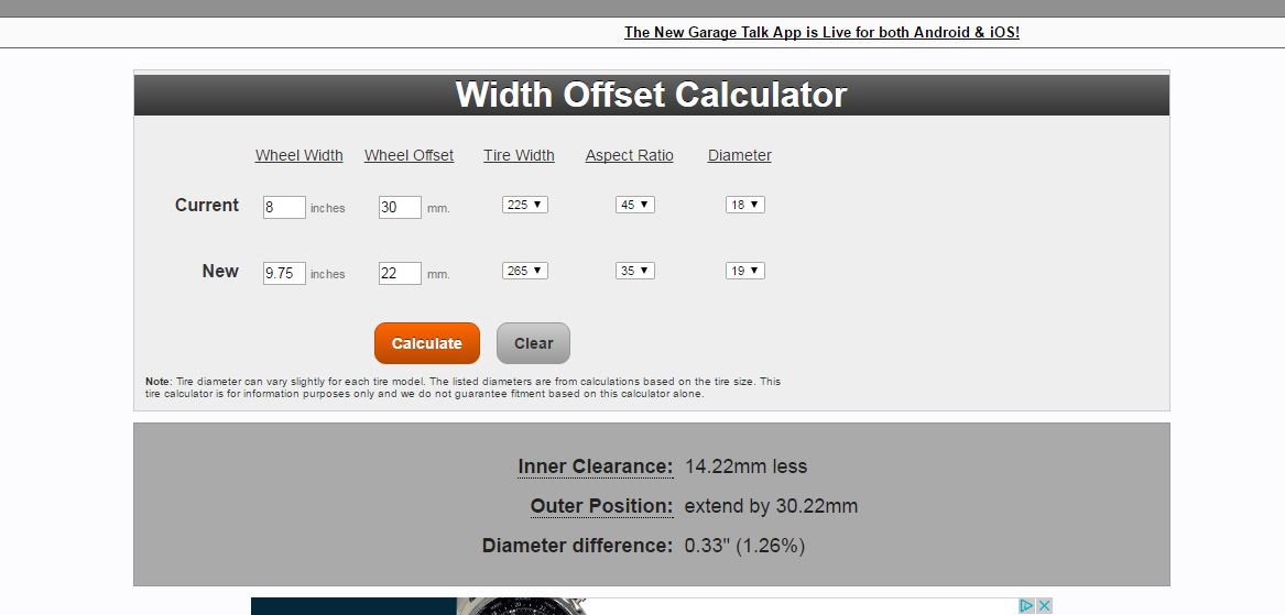

I don't mean to seem like a pest about this, but I won't be able to return these after I buy them (and it's not exactly a cheap expenditure)
245/35 for the front and it shows the first picture attached
265/35 for the rears and it shows the second picture attached.
The diameter difference is very small, there is a noticeable difference in the inner clearance and the outer clearance.

Those tire sizes will work fine. Pull the trigger on them, get them installed and you're golden! You can let go of the stress of the decision and just enjoy your new shoes. I love having all new tires on my rides, makes them feel like a whole different vehicle.
