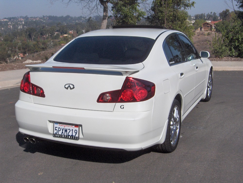

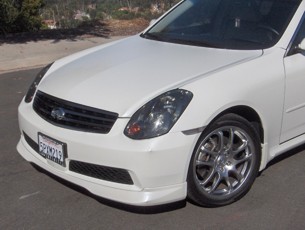

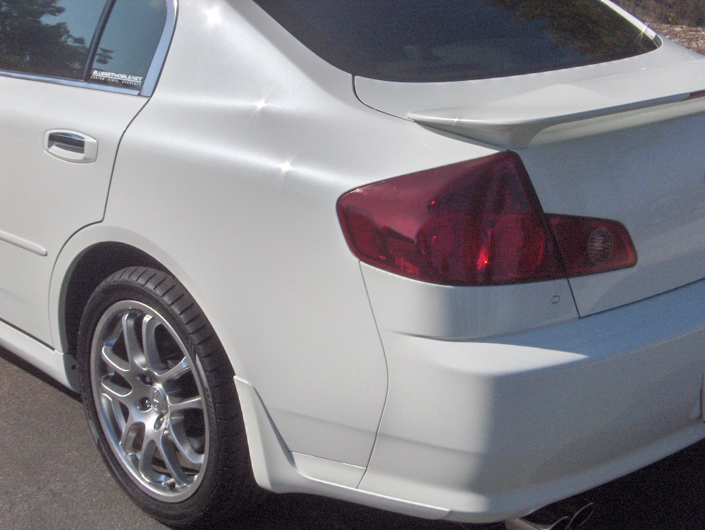

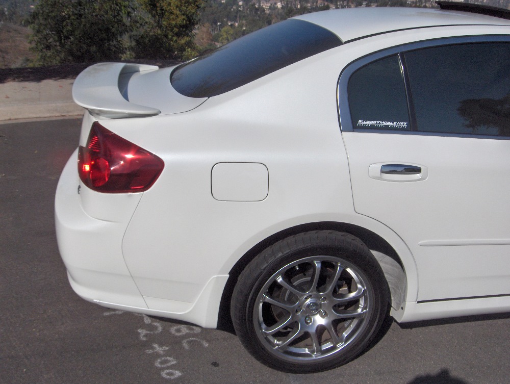

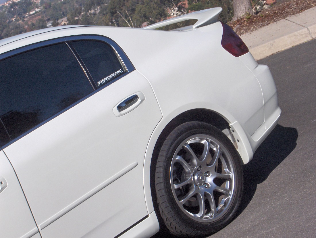

Yea i have a RWD but it's not lowered... yet. Will be next month when i get my new rims and Tein H-techs. Here's some pics of the car right now.
Tires for 05 18 sport rims...questions-gtr-6.jpgTires for 05 18 sport rims...questions-gtr-3.jpgTires for 05 18 sport rims...questions-gtr-7.jpg
Tires for 05 18 sport rims...questions-gtr-26.jpgTires for 05 18 sport rims...questions-gtr-4.jpg
-GP-

Gdup35sedan, thanks for your pictures. I checked your tires, according to the manufacturer, the rim width range for your tires are 8 - 9.5 inches. I am surprised your tires fit.
