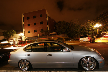

Hi guys, my tires are coming to the end of their lives and I'm thinking that if I'm gonna have to buy new ones might as well buy a whole new set of wheels. I own a 2005 G35 Sedan with just the standard 17" wheels. Nothing special like sports package or anything. I'm thinking of settling down with some 19" rims but have a few questions:
1.) I've heared that you need a "drop" to stop these from looking silly. What is involved in getting a "drop" and how much does it usually cost to get someone to do it?
2.) What effect does the wideness (8.5, 9.5 etc) of the tire have on the car apart from looking more badass (in my opinion)?
3.) What is the widest measurement (8.5, 9.5 etc) of rim and tire that will fit on my car without any problems.
4.) Will I be able to use full size tires on 19" rims with a "drop"? The slim tires look cool but I love the smoothness of the ride I have with my stock 17's. I heared that the slimmer tires make the ride feel more bumpy (kinda makes sense).
5.) Anyone seen pics of a G with rims like the one's in the pic below? What do you think of them?
Thanx for your help.

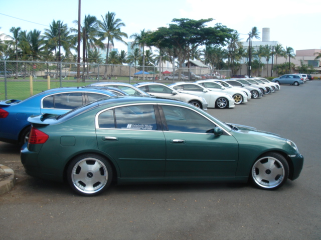

a friend of mine has those rims on his sedan. i'll post it up when i get off of work today (2pm hawaii time, so i'll post it up after 4pm).
Work Euroline DH rims are VIP.
Old Apr 7, 2006 | 11:31 AM
skeleton_cru's Avatar
Joined: May 2002
Posts: 17,096
Likes: 12
From: East Bay, Cali
Sedan
Originally Posted by sen_jen
Thanks for making me vomit.
