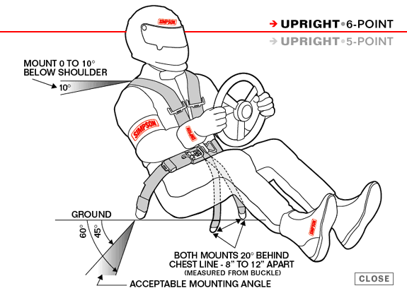

There are many universal bars out there, but the down supports seem to be pretty short causing the bar to slant downward too much for my liking. If you really plan on tracking the car like I do or really care about safety, universal bars are pretty sketchy as you do not know the strength of the materials, the amount of R&D, acceptable harness attachment angles and who knows if it would even pass tech...
So here is where I am... Buy a universal bar and hope it works and pray its safe or have one custom made... I know the NRG bars are universal, but their application chart lists both their 49" and 50.5" bar for the G35. I called them and they said you can run either one, but on the 50.5" the brackets will need to be reversed. Their bar is constructed out of aluminum not steel.

^ What he said. You say safety is a concern... You should really research what you're getting into. What classes are you running in? That will determine what bar you need if you need one at all. Do not sacrifice function and safety for a look! Not trying to sound rude, I just don't want anybody getting needlessly hurt.

Safety Harness bar is for show only. They will fold up and bend if used with aftermarket saftey harness belts in an accicedent.
