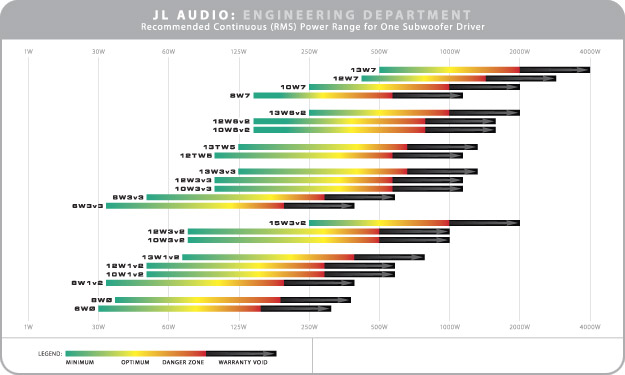

I would consider taking it back and going with a 500/1. To get good bass out of the W3 you are going to have to crank that 250 up all the way.

Great choice 250/1 and 10w3. You will love the system. A 250/1 is perfect. I would worry about zaping the sub I I used a 500/1. 500/1 puts you in danger zone.
Attached Thumbnails Best JL 250/1 amp install location?-sub_powerchart_mi.jpg

Thanks, that's what I kinda thought too from looking at the JL website. I would have gone with the 500/1 if I got the 10W6, but not for the 10W3. I think that will be just right, IMO.

I've been in the black with dozens of JL's over the years with great luck. If you take care and do it right you get the best quality and output when you give it more clean power instead of maxing what a smaller amp can do.

True, however too much is always (usually) better than not enough -- you will run into excursion problems with a sealed w3 before you run into thermal problems if you go with the 500/1.
The only reason I would avoid the 250/1 is the price/performance ratio versus the 500/1, since zBay usually has them for around $100 difference (for twice the power!)
So I think you should be good to go, just remember that you have a single sealed 10 when you are tuning, don't be the newb that turns it up until you get mad bass at volume 2.
