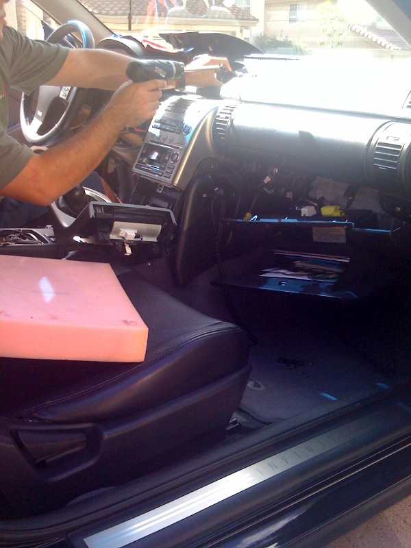

Here's my report back.
Radio Medics solved the problem by repairing and beefing up my power supply to my original head unit to decrease the likelihood of a repeat problem . Everything appears to be working fine. CD changer, AC, Radio, and Satellite Radio all work fine.
Fast, friendly, professional service. Rob came to my home and removed the unit and shipped out to their service center. A week later he returned and reinstalled my unit. Repair/parts/labor for approximately $300 and some change. Well worth it to keep and maintain the original factory look.
I'm having him come back and install an iphone/ipod adapator for me.
I am very happy. Thanks for the info supplied from this forum. Otherwise I'd be stuck having to deal with the Dealership that wanted $1800 and told me the unit was NOT repairable.
