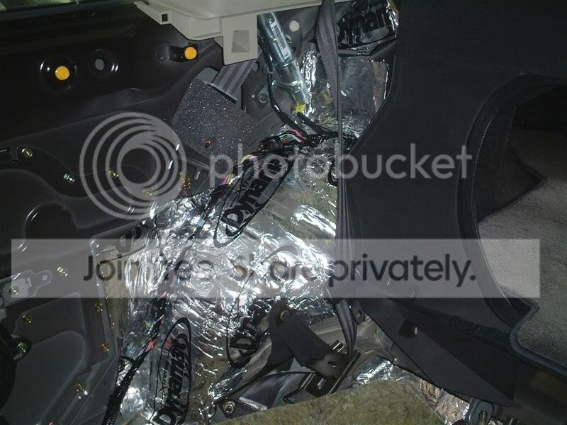

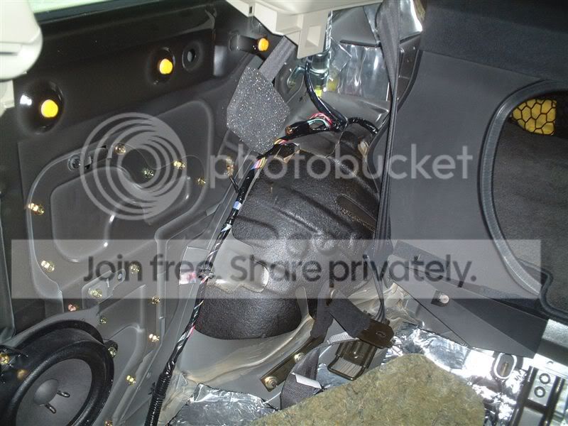

It's the same as what others have done. I just put two layers on the wheel wells and one layer everywhere else. Here is what 6MTHavoc has done:
As far as the wheel wells go in the trunk of the coupe, you can't dynamat the right wheel well in the trunk, only the left one. For the right side, your best bet is just to cover the boxy area around the wheel well, which I think is the fuel pump/system.

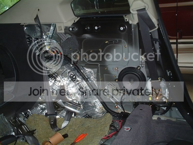

afr0puff,
do you see those screws on the side. I opened up those and dynomated the side last weekend. It's a pain but well worth it. I did the rear well just like you. Also i did the rear passenger seat too.
This weekend i will do the trunk. What i really want to finish doing is under the driver and passenger seat. The last portion will be the top where the sunroof is at.
