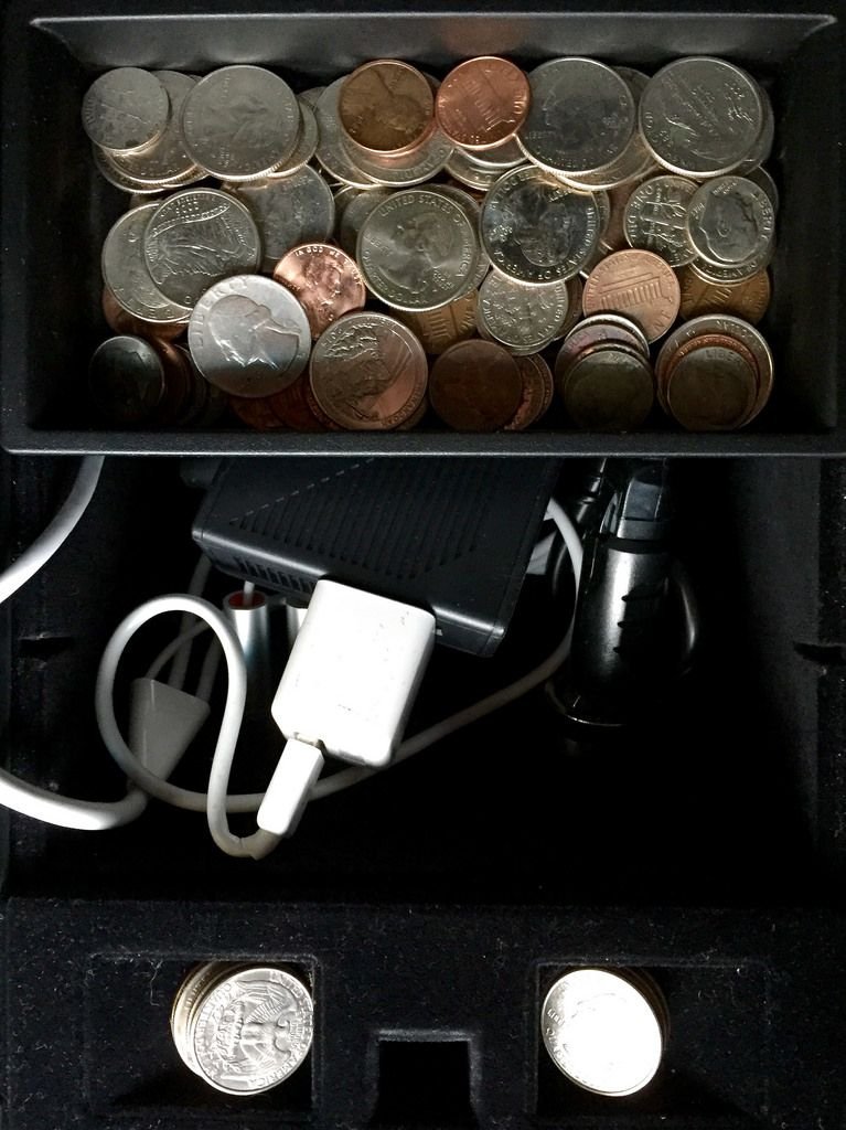

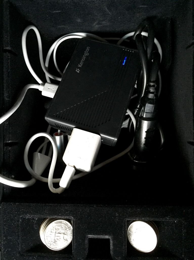

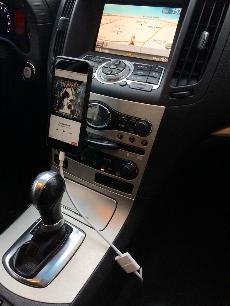

I'm a very happy camper now. The Kensington Auto/Air Power Inverter worked. I was nervous at first because when plugging into it's USB connections, it was actually much more noisy, but when plugging into it's standard plug, it is dead silent. Now I have no noise with playing music, can charge my phone, have easy access with my fingers and can just use Hey Siri (being it's plugged in) and control everything handsfree. I am using one of it's USB connections for an additional charging cable so I can keep the ashtray closed.
As for non-power cables, I'm using the Apple Composite AV Cable to go from RCA to the old style 30pin iPod connection, then having that connect to the .2 meter Lightning to 30-pin Adapter. Using that Lightning "cable" rather than the small adapter without the cable allows me to fit through any case I use on the phone.

Where you able to see what the iphone shows onto your screen of the g ?

No, the Lightning to 30 pin adapter will pass audio but not video. Considering where the iPhone sits though, I have no real want for anything to show up on the G's screen. I can see the iPhone perfectly and easily touch it to skip tracks and such with one finger while my hand rests on the shifter. And though it would have been nice to be able to install USB to control it from the steering wheel, it's actually easier to not touch anything at all (including my iPhone) and simply say, "Hey, Siri, shuffle my Rock playlist" rather than drilling down through menus. That's the main reason I wanted to be able to charge my iPhone at the same time (without noise), because Hey Siri only works when charging.
