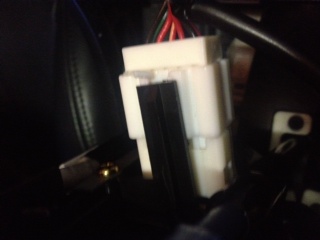

Hi, there. I recently attempted to install my iPod kit but I ran into some problems taking the dash apart. Anyways I didn't get far as i managed to remove the gear shift trim on my 06 5AT (Yes, i KNOW ) but unfortunately I wasn't able to remove the connector which attaches to that trim piece. Can anybody advise me on how to unclip this connector.
P.S. Does anybody know the part number for the C-Clip (Gear shift clip). Knucklehead me managed to drop it in between the seat and the centre console.

You just insert a screwdriver right below the push-tab. Push hard and rotate at the same time, it'll separate them enough that you can then just pull the two halves apart easily.

Thank you! When I tried that I saw the plastic flexing and I didn't want to snap it incase that wasn't the proper way to open it. BTW What about the black piece on the other side of the clip which holds the two parts together?
It shouldn't be holding them together, just holding the one side in place.

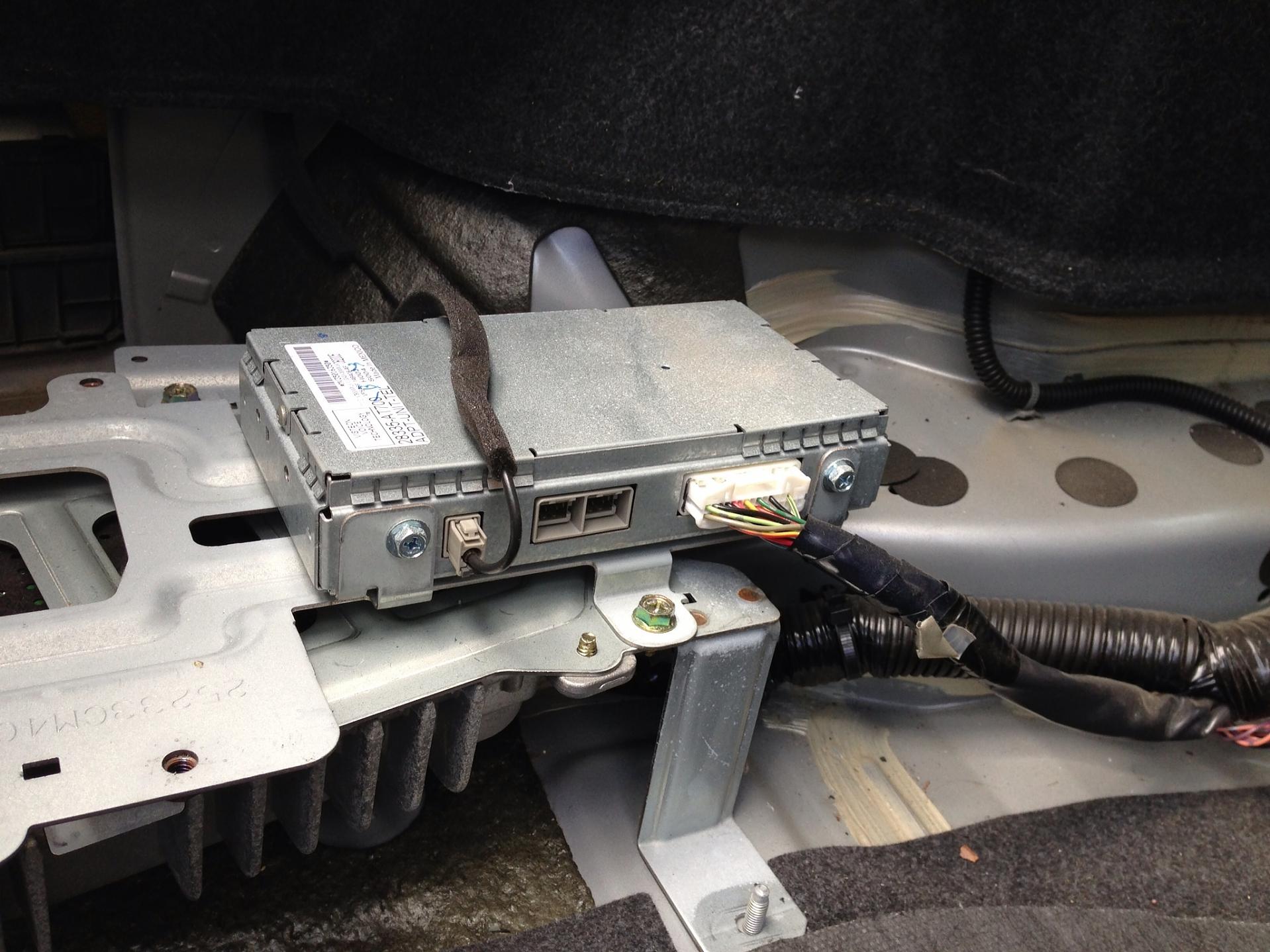

An '06 coupe here with the sat in the back but no special buttons up front. Just radio. So the "iPod to Factory Radio Interface PA15-INFI USA Spec PA-INFI iPod Interface" hookup will plug into attachment 1 and then also run to the head unit? Or just sat in back... That would be may Bueno. I want to be able to set a playlist and go + play pandora on an IPHONE 5 <Assuming this is a problem>. Should I just buy the 30-pin > Lightining adapter? Thanks Wrathernaut and others.

Interested in running an aux for my 03 coupe with bose w/nav....Wanna play pandora on my phone through the radio. How do I do this(whats needed)?

I did read it,but im not exactly stereo inclined...Was wanting the easiest route,which was thinking the plug and play option..Going in the trunk of SAT..but not sure on how this works..Just don't want the hassle of pulling head unit out if possible..Sorry im a stereo noob

In response to your answer to 'Its a g thing,' I asked a specific question asking if the plug "Only" goes through the sat prewire box in the back. I'm asking because I don't want to have to deal with pulling out the HU if I don't have to.
Also, what should I do about my iPhone 5?
