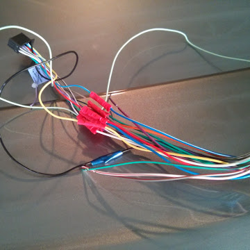

Pic of the current spider wiring mess? I am imagining you are having an issue with your switched power if it won't even turn on!

I can put a picture up but I used a volt meter to check all the connections and they're all connected and good.

Here's the rat's nest...

Well the cardinal rule is never to crimp but to t-tap. I'm going to go ahead and say redo that crimp and you'll be amazed how you missed the copper.

Would I need to recrimp if the volt meter is reading a connection on the main 3 wires?
I don't know about what clergy use for connecting wires, but the best method by far is solder, preferably heat-shrinked.
T-taps have their place, like if you're just trying to add something temporary, or there's not enough play in the wires to solder in a proper connection, but I'd never use them as a primary connection method.

Regrounded it and it works now!
